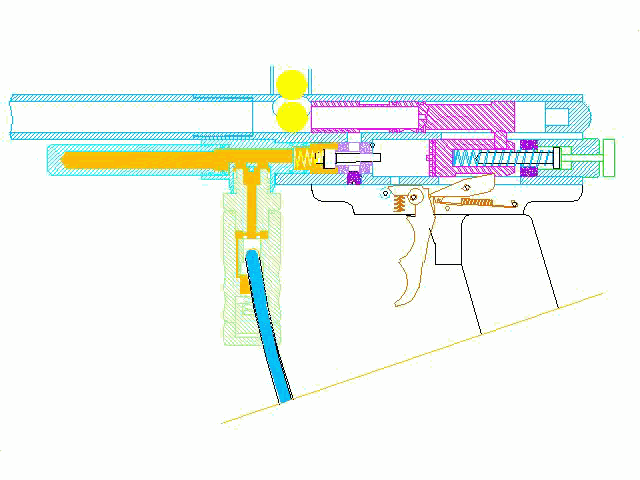

Tippmanns and Kingman are both poppet valved. The only real difference is inline verse stack tube. Kingmans are identical to piranha, most of the parts are interchangeable. On Tippmanns the cup seal rest up against a brass plate called a valve seat inside the valve assembly. On stacked tube blow backs (STBB)the gun body contains the valve assemble, and the cup seal rest up against the valve body. Where tippmanns use a small brass plate and an "o" ring as the valve seat, STBBs just use one solid piece. STBBs are actually easier to understand because there are fewer parts. hopefully this helps.

The main reason it may be leaking is that you put the centering ring (ninja star) behind the poppit.
It goes spring > ring > poppit > marker.

No it's on right. I have been watching that diagram thing and I don't know what else would be wrong.
