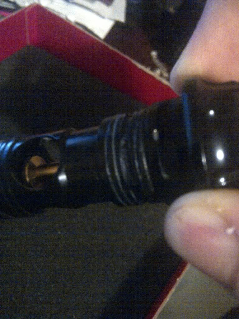

would this little scratch on the invert mini bolt guide cause it to leak?(that's the part where the screw holds it in place)
#2 User is offline   BraiNfreeZe
  • Posts: 618
  • Joined: 14-December 12
  • Location:'Merica
Posted 30 January 2013 - 09:42 PM
It could I guess but I wouldn't think so. I would take it apart and lube/replace the o-rings first though.......

Posted 30 January 2013 - 09:44 PM
No. All the seals in the gun are achived with either orings or delrin, metal doesn't matter.

Posted 30 January 2013 - 09:57 PM
how many orings should be on the bolt guide i have 6
#7 User is offline   invert22
  • Posts: 23
  • Joined: 30-January 13
Posted 30 January 2013 - 09:59 PM
its leaking from the bolt area

Posted 30 January 2013 - 10:04 PM
View Postinvert22, on 30 January 2013 - 09:44 PM, said:
not being lubed would make it leak?
It could, or the O-rings could be bad and you'd need some new ones. I would try lubeing it first, if that doesn't work ansgear.com has rebuild kits for cheap.

Posted 30 January 2013 - 10:18 PM
Check your poppet seal and re-set the poppet.

Posted 30 January 2013 - 10:28 PM
k I just re lubed it and reset the poppet. I have no air left so hopefully the next time I go it is not leaking. thanks guys )
