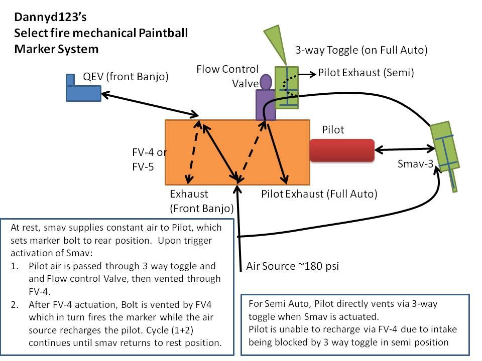

For the cyclone, if you are using an ion, it might be an issue if you hook up the exhaust to the cyclone as it might impare the funcion of the marker. The cyclone is designed to run off 800psi output the tippmans are run on. Not saying that it cannot be run at a lower pressure but it would take a lot of air to operate. You may need a separate inflow. If you are using my system, I would utilize the inflow coming from the flow control valve port of the fv-5. So in between i would put the connection to the cyclone. This should work on the full auto setting with some tuning. With semi, you will need a quick trigger pull or else keeping the trigger depressed will vent air.
See here:

Wow thanks for the help and detail, wondered if the Cyclone neds the 800psi to operate,I'll hook a microline gauge I made to an A5 to check.
This gives me much food for thought :D,simple but effective design you've come up with
