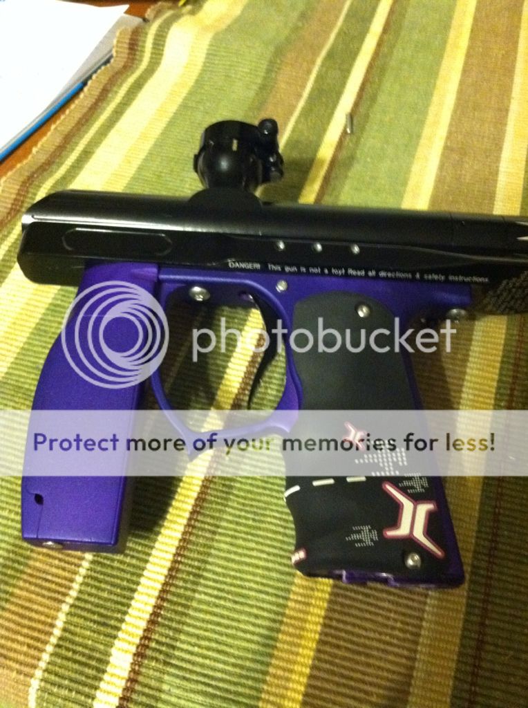

Would love something like this but with my personal touches

Just heard that a axe mag is also possible. Looking into it
Edit: new take on a minimag lol

I think that is an 05 ego frame, not an etek frame. Another good option for having a screen.

If I can pick up a star frame with everything then I would, but I think a ego 5/6 frame would work
