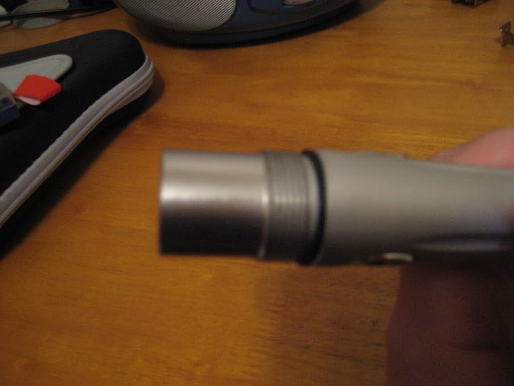

can it be done on this? the thinnest part on the barrel are thicker then the freak insert

looks like it would be fine. Can't gaurantee the strength of the barrel after I do - but yeah, should be able to.

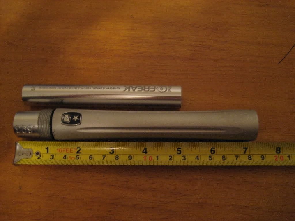

Yeah, if you could bore out my .693 back from my stock ego barrel I would definitely jump on that. I'll take some pics tonight if I can remember.
#35 User is offline   The_Economist
  • It's business time.
  • Posts: 2,314
  • Joined: 09-October 08
  • Location:NW Indiana
Posted 15 November 2010 - 07:03 PM
I remembered!
Shaft 3 back length is 7 3/16".
OD on the thinnest part in the middle where it tapers in is 13/16ths.
OD on the part in the back where it threads into the gun is also 13/16ths.
ID is 11/16ths.
There's still about an inch of control bore that extends past the length of a freak insert before the bore for the front threads starts.
This post has been edited by The_Economist: 15 November 2010 - 07:05 PM

Posted 15 November 2010 - 10:10 PM
should be doable. just a bit tricky to grab in the lathe since it doesn't have any good cylindrical spots. yeah, I think I would be willing to try.
