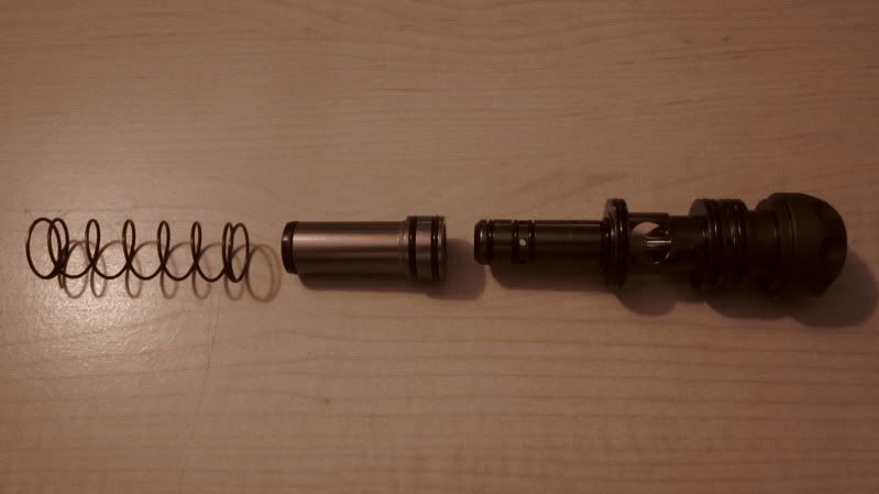

-The engine is one large section with the orings on top of it. About as close to idiot-proof as you can get. Unlike the Marq engine, you won't have to worry about putting it in upside down and blocking the air transfer holes. After you're done lubing it, just guide it in with the notch on the body.

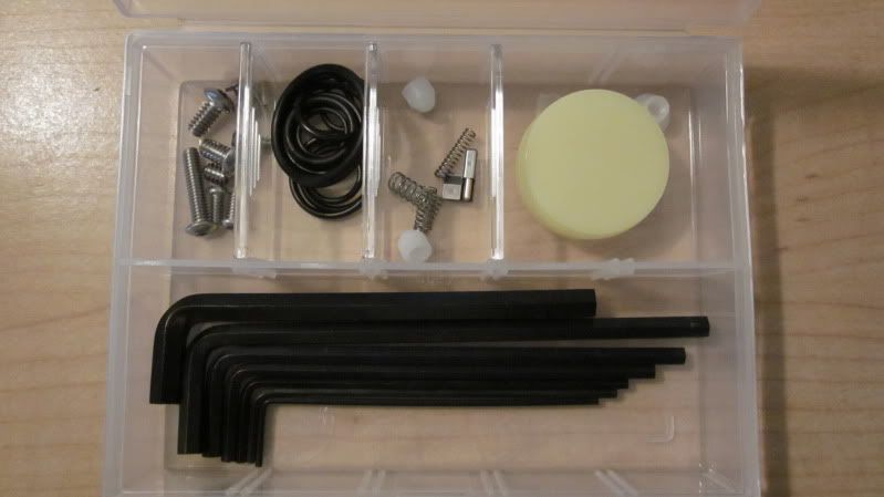

-Empire also gives you a nice little tool kit to go along with the Axe. Its got all the allen keys you need to open up the Axe. It also contains lube, orings, screws, and spare detents. Finally, a manufacturer figured out that screws get stripped and need to be replaced! :bowdown

Standard Toolkit:
Empire Axe Engine:
