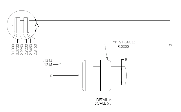

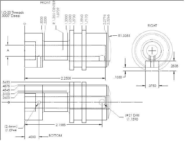

View PostPanda, on 23 January 2013 - 11:36 PM, said:
Oh God I found schematics on how to mill out an e-bolt ram.
Wanna share with the rest of the class?

Posted 24 January 2013 - 07:03 PM
Only because you asked Andrew.
In no way, shape, or form are these drawings mine.
I merely only saved them from PBN in the case that they would be deleted from ImageShack and I would have no schematics. Then I would be at square 0 again. I believe they are from "NaturalNewbie" originally.
http://www.pbnation....d.php?t=1866954
^ Thread I pulled it from.
http://www.pbnation....d.php?t=1875097
^Thread showing installation and directions to give the machinist.
So apparently if I bring these drawings to the machine shop, tell them that the rod needs to move smoothly in the ram and will create an airtight seal with an o-ring, I'm good to go.
Again, I claim no ownership of these photos. They are merely archived in my private library in cases of deletion from the original thread.
Reading further into the building thread, it seems as though the ram is somewhat difficult to make.
I would gladly do a middleman thing with a mod or someone to where they make the ram for me and I pay. But that's not gonna happen.
Hopefully I can get myself together and get some money for this project soon.

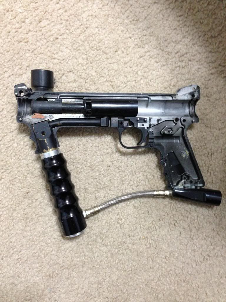

Posted 25 January 2013 - 10:05 PM
This is what I have to work with.
All internals not needed were taken out and set aside, and the previous owner even polished the internals.
Give me gunz for my gunz.
