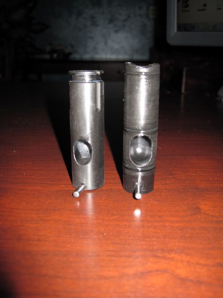

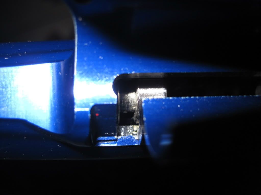

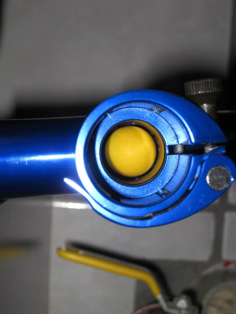

first of all this are my prototypes some of them are not even finished they all are hand made

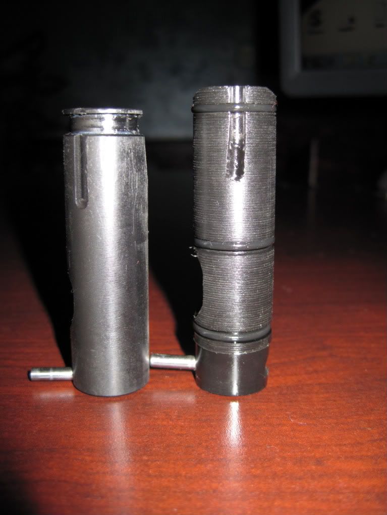

This bolt has:
reinforced back
3 Oring bolt
venturi mesh on the back with open bolt face
bigger internal diameter transfer hole
longer bolt with a juit gentil pball face so no roll back a big +

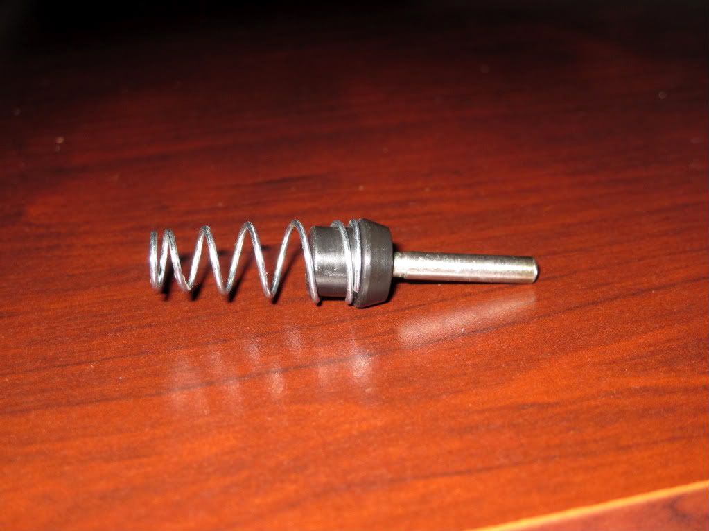

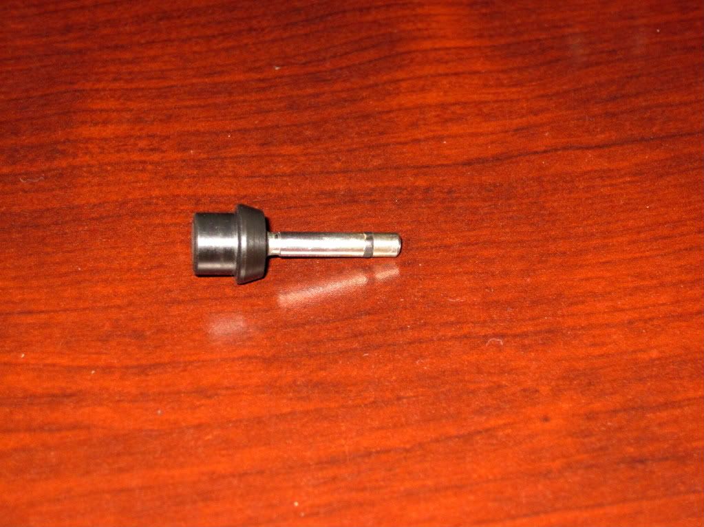

Juit EGO valve MOD
you will need a EGO valve and a intimidator gen 2 or 3 spring
I cut the ego valve shaft with a dremel same lenght as stock valve
then reversed the timmy spring
The gasket MOD

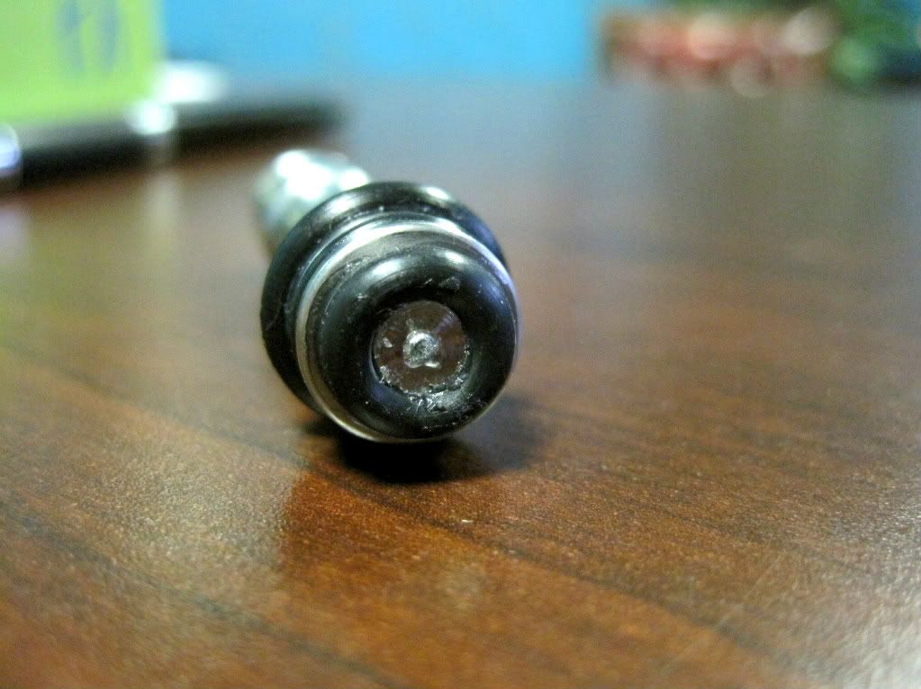

I made a groove on the valve pin
5 mm away from the tip
used a timmy gasket
then shave it untill it fits tight in the valve
then add some grease
this will eliminate 50% of air blown from the back of the gun
Super Bumper MOD

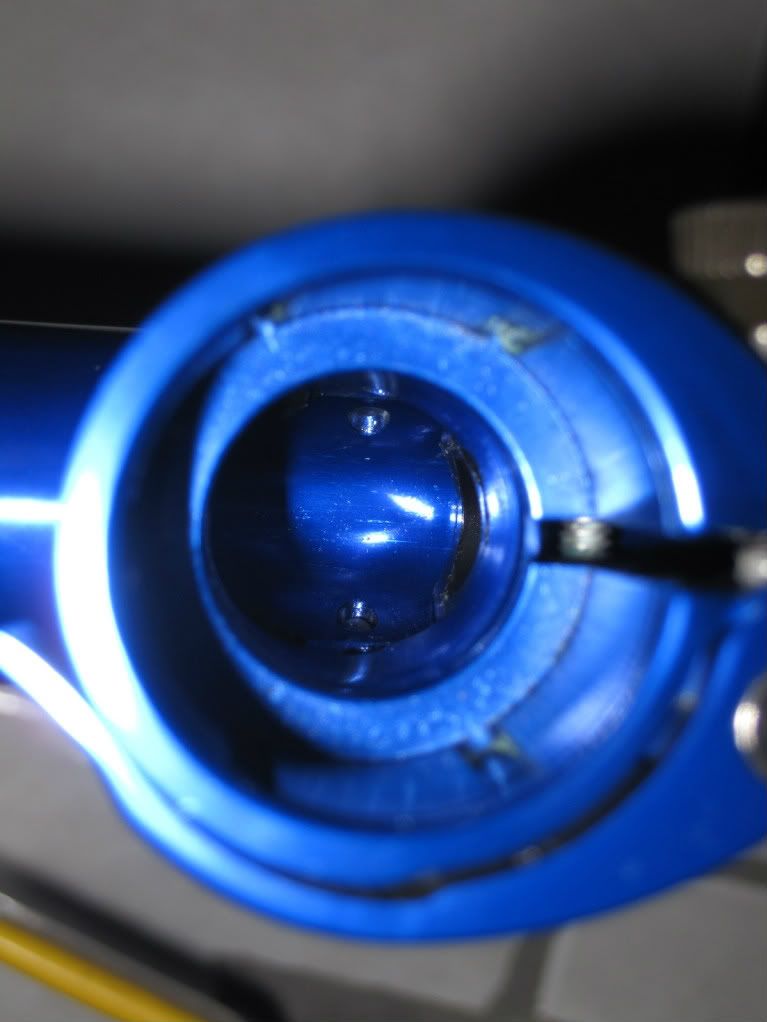

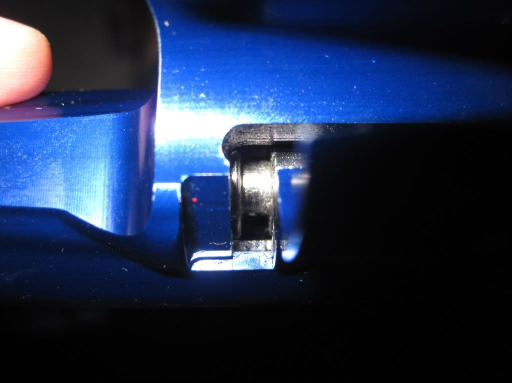

I found this Oring in my box
first clean the surface & the oring with acetone
then crazy glue the Oring on the back of the ram
this will cancel a lot of the kick on the marker
no air on marker
aired up
either way the bolt can be installed or removed without any problem
Results IN MY CASE:
8 dwell 160 HPR and flushed LPR 292 FPS
[url="http://www.youtube.com/watch?v=PgJqWIag1w4"]http://www.youtube.c...h?v=PgJqWIag1w4[/url]
sound was cut down to 25 DB on my digital DB meter
minimal kick
Eliminated all the blowback air by 95%
on my tests:
I use reballs on a SS bigshot and a 682 lapco bore sizer, red field Chrono
Disclaimer:
Im not responsible for any damage or if you null your warranty
in this case I made this mods because I dont give %$&* what happens to my markers, if this is your main gun prolly need a back up marker
I didnt invent the bolt or the cuts I made on it, this is a combination of all the good ideas I've collected over my years of playing paintball
I've contacted Macdev and let them know they can still improve this marker
future MODs:
solenoid subplate
LPR tester
planing to add a frontal valve bumper with an extra longer valve to compensate the mechanical dwell
make an aluminum ram with a lurker timmy spring
polish the ram and ramsleeve
put a gasket on a stock valve
use an autococker valve with gasket
modiffy the front ram sleeve
make my own poppit valve
a new manif
Now Im happy with my RX Posted Image
Posted Image give me any marker and I'll make it shoot better Posted Image
