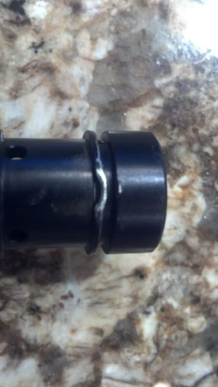

Ya, that's kinda what I figured. But the gun does hold air in the reg when you flip the asa, its not much, but it's caused problems for me before. This was just some new symptoms. I'll be taking it apart shortly.
Edit: So i'm pissed...
And here's why: Posted Image
:tdn: :tdn: :mad: :angry: :dodgy:
