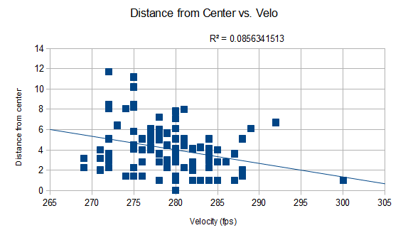

I took the liberty of graphing shot velocity verses height:
Within the given dataset, the trendline that maps this data has a coefficient of determination (r^2) of .0004 (where 1 is a perfect line) Just to give you an idea as to what a GOOD r^2 value is, I frequently threw out data that was worse than .96 when I worked in a lab. I can say with a VERY high level of confidence, within this dataset, there is no correlation between shot velocity and impact height.

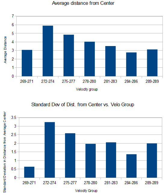

So I did a little more digging, and decided that even with 100 shots the statistics were still not good enough to make a solid conclusion. Here's a graph of the distance from the average center vs. velocity:
It looked to me like the shots that were at a higher velocity tended to be more accurate, so I broke things down into velocity groups to get a better picture of what was going on.
If we ignore the first and last columns (the first has only 5 datapoints and the last 6, not enough to get a good picture) we can see that as the velocity increases, the average distance to the average center decreases. Also, as velocity increases, the spread (less strongly) seems to decrease.
Since we've already seen that the increase in distance from center is not a result of velocity fluctuations causing the ball to fall short, this data seems to support my hypothesis that more energy used to spin the ball results in lower translational velocity, and also causes a larger spread (in any direction)
It also makes me wonder about his bore, paint size and paint quality.
