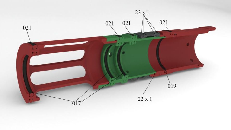

look inside the can, there is a really thin o-ring that has a groove it needs to fit into make sure it didn't pop out, also check the air transfer port o-rings. the part where the frame connects to the body.

I've had several problems with my demon as well with the same leak. Even when I went on Sunday it had it once I got to the field even though I checked the day before. Couple of things, use Dow 55 only since those orings need to swell, make sure your shuttle valve on the bolt faces the right way (there a lip on it and that needs to face the front of the bolt), relube the transfer hole oring with Dow 55, make sure the orings inside the shuttle are generously lubed up, and last clean and lube the reg orings good enough too. That's how I fixed it Sunday

If you ever have problems feel free to PM me and I'll take care of ya, the most common issues are either too little lube on the shuttle valve (The ring that slides back and forth) or the interior 017 bolt guide orings lacking lube.
