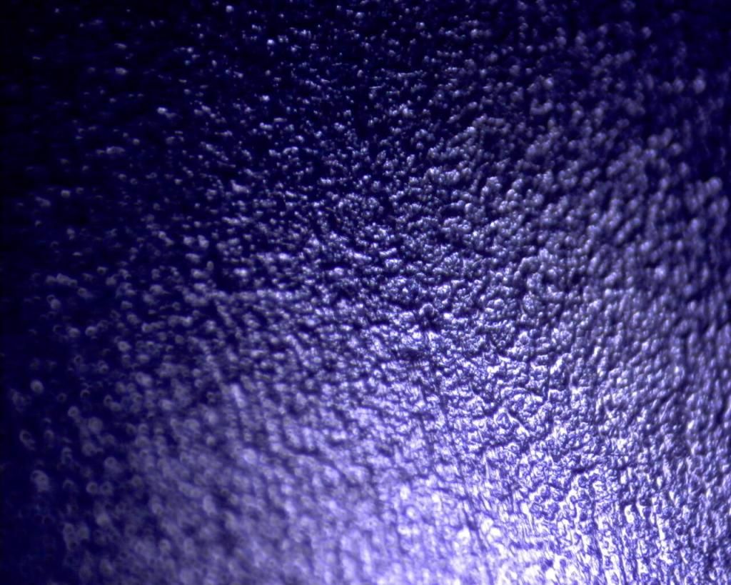

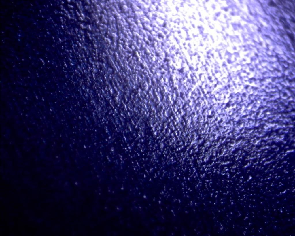

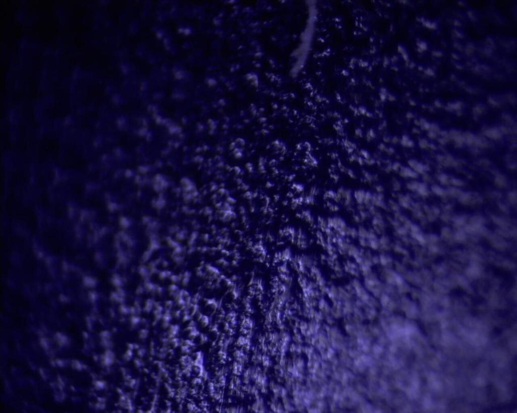

Most barrels are anodized inside, so much of the original "polished" surface is degraded. They're really not terribly smooth to begin with. I took some pics of the inside surface of a couple of barrels-
at 100x:
And at 200x:
Looks like the moon, no? :)

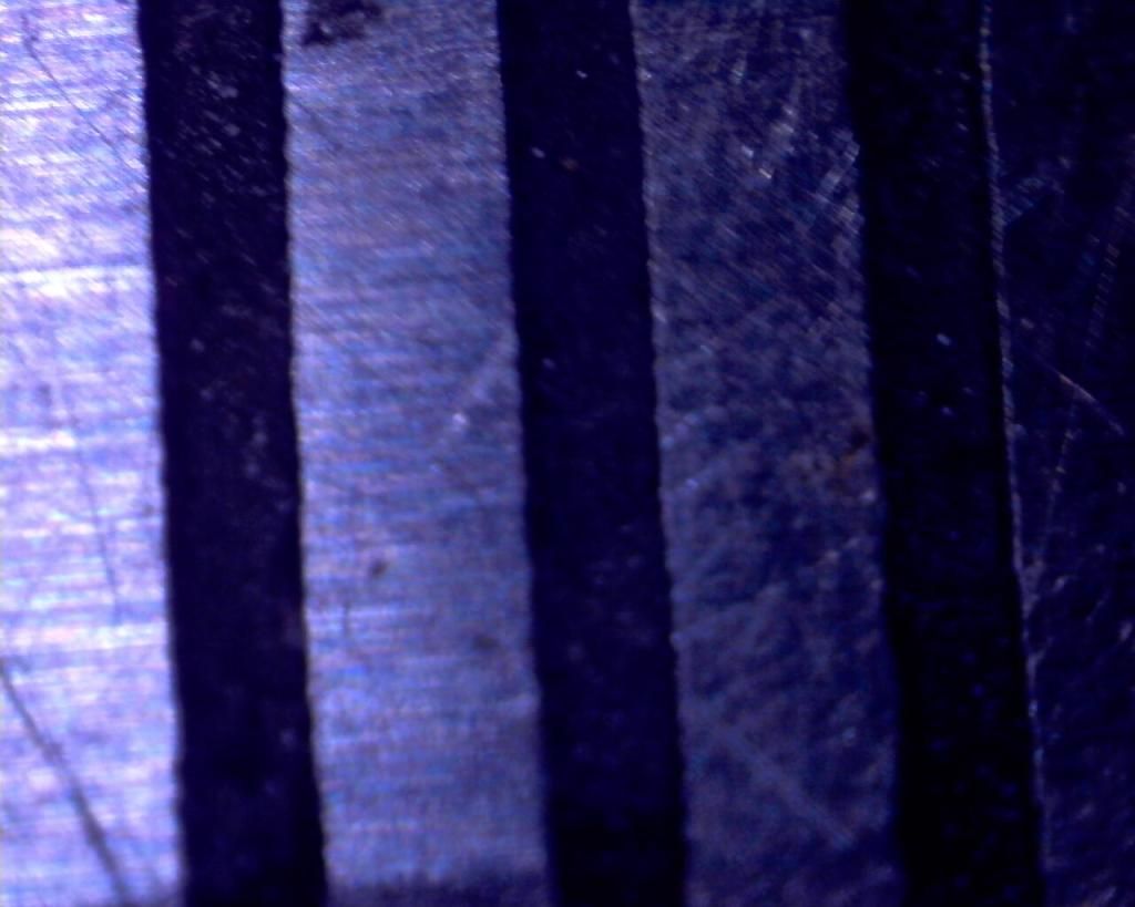

To give some scale to the above pics, here's 1mm gradations on a ruler-
at 100x:
#12 User is offline   andrewthewookie

What barrels were those?
Fear is the mind-killer
#13 User is offline   rntlee
  • Posts: 402
  • Joined: 30-September 08
Posted 01 November 2012 - 06:08 PM
One was a well known aftermarket brand, I won't say which. One was an APEX barrel (taking these pics requires destroying the barrel of course). I have others I could post up too, but they're all similar.
Anodizing the aluminum creates this finish. If you look down the bore, they all look quite shiny and smooth, but they're not actually.</div>
