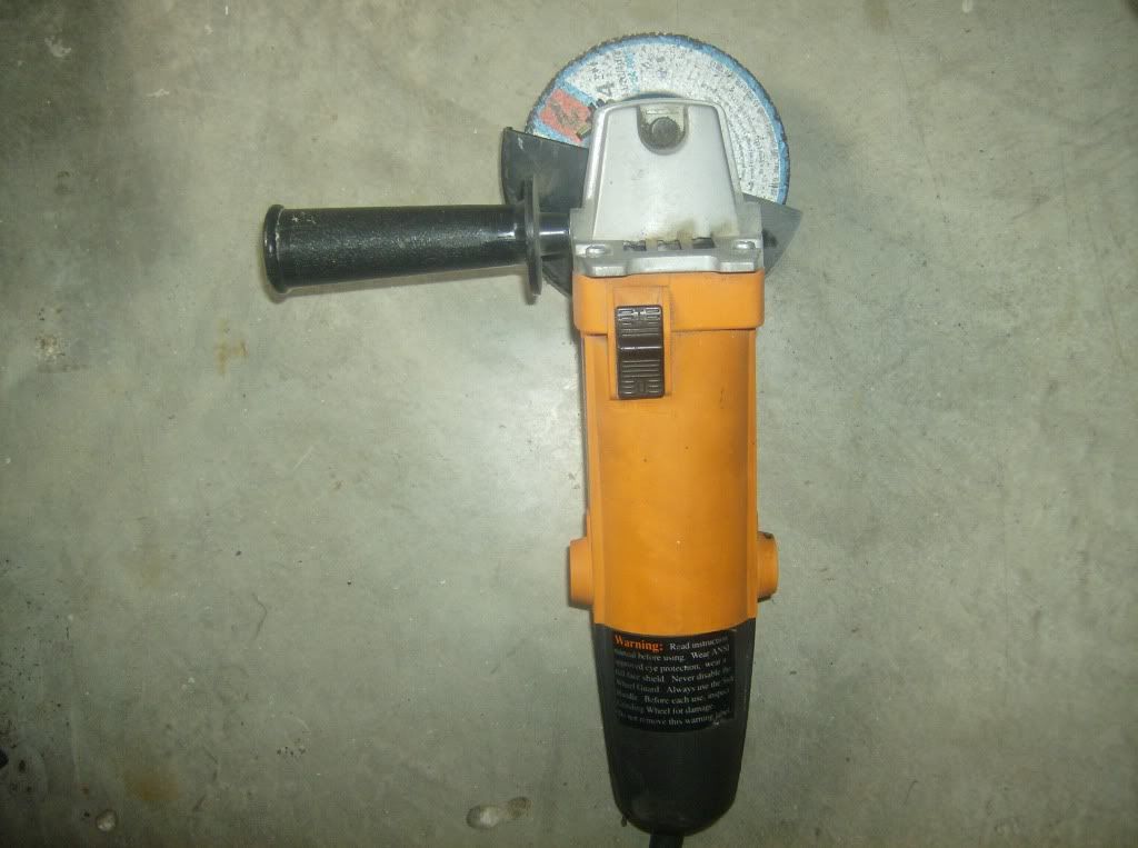

Then you want use a dremel or an angle grinder to make a slit for the ghost ring. You could use a hack saw or some other type of saw for this. Whatever works. You want to cut it about 0.3 to 0.4 inches. After that, you want to slim down the edges of the ghost ring to fit on the phantom. This will make a tighter fit and secure it onto the rail.

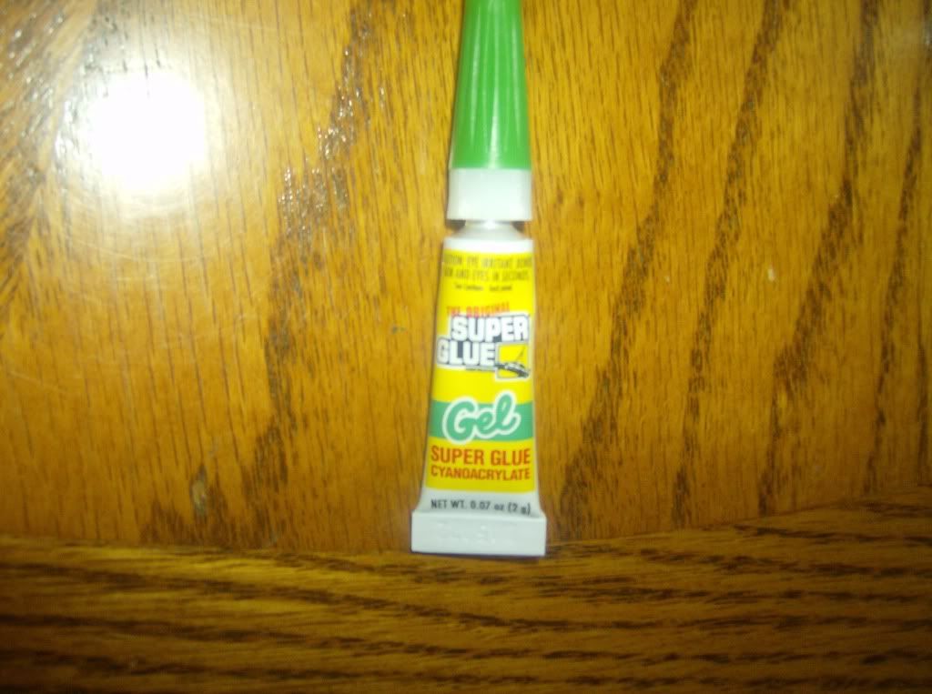

Super glue the nail/screw to the Ghost Ring.
