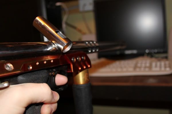

well finally got the chance to become part of the Mag fam. picked up this RT for cheap. works just fine seems easy to breakdown/maintain. question for you guys though. is the "foregrip" just a gas-thru or is it a true regulator of some sort? if its just a gas-thru can i simply run my macro from the asa to the back/side of the gun. obviously have plenty to learn. my biggest problem is not knowing what the differences are between say the RT, RT Pro, RT ULE, etc. so its hard to know what i can and cant do with this marker. any and all help is appreciated... on to a couple of pics.

Gas through. And sexy RT. :wub:

Wait. I think you're missing a feed plug. You might wanna pick one up from Roman at AGD.

Yea your missing a feed plug. Also, 850 PSI at minimum for your input. Dont put a reg on the gun. The back half of the valve is a regulator so putting two regs on the gun will strangle it. Mags love high pressure, so the higher the pressure the more reactive. But above say 900 PSI Id use Steel braided line because I wouldnt want a macro line blowing in my face at 900+ PSI.

I run macro on my mag, but the steel seems to complete the look for the marker.
You may run the hose in a "C" shape from the ASA to the Valve directly.

thanks for the help. i have the feed plug, just wasnt in for the pic. besides the barrel and asa it seems to be all stock. it came with the ANS bolt but from what i've read that isn't much of an upgrade, so i took it out n put the stock one in. what upgrades would you guys suggest?

There's a good side and a bad side to those RTs. The good side is that you can't really upgrade them. That will save you hundreds of dollars. The bad side - you can't really upgrade them.
As for walking - that's not really going to happen unless you do some sort of pneu converstion. The way to make an RT go really, really fast is to crank your input pressure then you can sweetspot the trigger and make it go into really fast full auto. The snappyness you feel is the RT (reactive trigger). It's designed to pop the trigger back very quickly.
I'll double the info - but that's a gas through grip. the gas actually goes through the rail on those (that's the chunk between the body and the grip frame) - so you can hook things up all over the place on all those plugs. There's a picture somewhere of CockerPunk's RT with about 12 feet of macro looping all over the place.
Grip frames are pretty much the only thing I would consider changing on that gun - it's nice.
