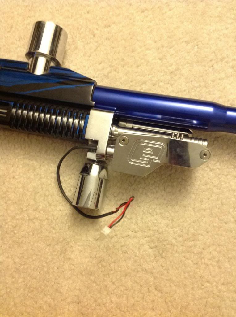

Took me quite a while to get it cleaned. I got it up and running today, although I do have to fix a minor blowback issue. Just gotta get my tanks refilled. Here are some pictures!

Posted 07 February 2013 - 10:25 PM
Descent, I love that frame :wub:

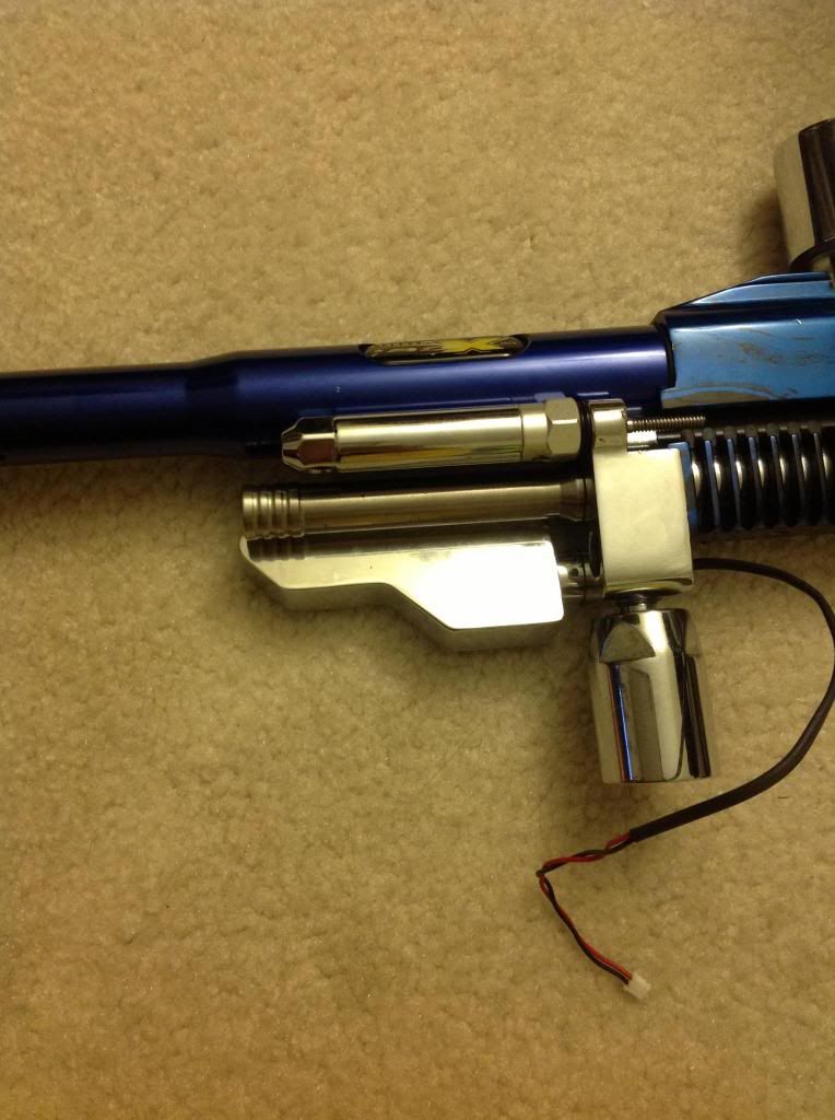

First round of parts came in the mail. E2 front solenoid, belsales ram, and belsales delrin bolt. I understand now why belsales stuff is top notch. This ram is so ridiculously smooth.

Posted 16 February 2013 - 12:35 AM
Got some parts in.
#2048 andrewthewookie
andrewthewookie
    Shaaaaaaaaaaaaaaaaarks
  • Chat Coordinator
  • 22,424 posts
Posted 16 February 2013 - 12:42 AM
Not bad, not bad.
#2049 OEFVeteran
OEFVeteran
  • 4,031 posts
  • Location:Norwood, Mass
Posted 16 February 2013 - 02:51 AM
if you drill that body i will find you and hurt you....
