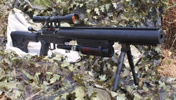

Posted 31 August 2011 - 01:33 AM
It's been done and is very double
You need to Separate the Bolt from the hammer So you Can Control when the ball is loaded
Infact
She could look like this and Since I know someone will ask it's not mine I can Let you know where to contact the person who owns it

thats a lot of stuff done to that, very nice. project will start soon, keep you updated
