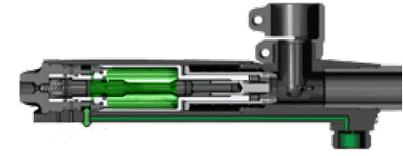

I'll see if I can make an animated bolt cycle so everyone can see what actually happens in the gun.

As promised, here's a .gif of the engine in action. Blue is from the solenoid. Also, the bolt return is separate from the movement of the shaft. It will move backwards when the pressure is released from the firing chamber, not necessarily when the shaft starts to move forward.
Edited by andrewthewookie, 15 October 2011 - 10:40 AM.

Sorry... But... Looks like a spool to me. I dont see any poppet being hit in order to open the valve.

PE calls that central shaft the "firing poppet" in the manual (which is now up on PE's site), but all I see is a dual stage spool.
Edited by andrewthewookie, 15 October 2011 - 03:12 AM.

Indeed. Poppets get smacked. (or pushed) But I guess if they want to call it a poppet, so they can try to edge into the "inline poppet" market... Whatever.
Definitely has some major similarities to an automag.
It'll be intersting to see how smooth and efficient this thing is.

It's basically an automag that doesn't have constant pressure on the bolt. They've taken the classic design, and engineered it so it doesn't need a sear.
I do have a question though: in yor .gif you said the blue is from the solenoid. How does that part of the bolt function? Does the pressure from the solenoid push the shaft back to release the pressure into the bolt?
Edited by larryjerry1, 15 October 2011 - 12:46 PM.
Yes. Of the two o-rings that seal in the blue space, the rear seal is larger than the front seal, meaning that when pressure is applied to that area, there will be rearward force, pushing the central shaft backwards. When the solenoid is turned off, the pressure stops, and the spring that sits behind the shaft pushes the shaft forwards again.

its confusing as fuck...
It's actually quite simple, except that there's two moving parts.
Nice job on that GIF. it really helps a lot!
Thanks!
