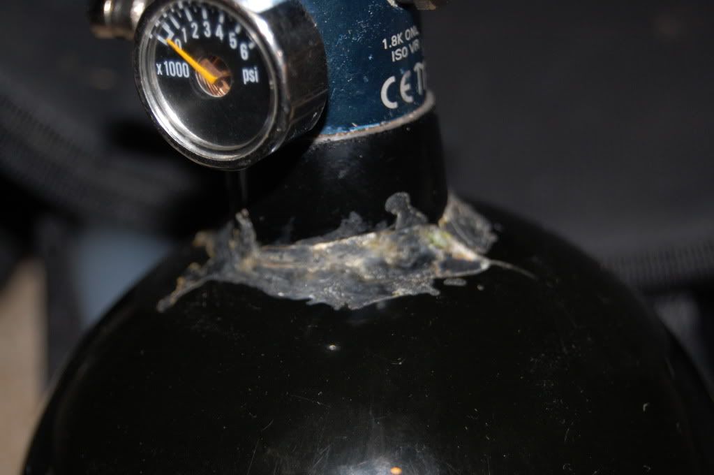

just bought this tank and am wondering if it's still usable

I wouldnt trust it. I'd probably take it to get re-hydroed, regardless of the date.

personally i wouldnt use it. But technically if its just cracks in the clear coat and not the fiburs you should be fine. Go to the ninja paintball section in the manufacturers. Theyre really helpful about any tank

That's bizarre, get it hydro'd or call Ninja or something.

Tread with caution; it may be ok but it looks like significant damage to me.

I have question for you, how did that happen? hahaha

yea definetly get it rehydroed. you get it rehydroed and its safe=money well spent
no rehydroe and its not safe=medical billz and those are a lot more then $30

That tank is toast.
Do not try to use it or have it filled.
I've seen that kind of damage before and it takes one hellava hit to cause it.
My question would be why is there a 6K guage right next to a printed rating of 1800?

^i would listen to this guy. hes a certified airsmith so i think thats a pretty good resource

I don't think it would take an airsmith to figure that one out. I wouldn't test it dude, unless you want to blow your shoulder off.

That tank is toast.
Burst disc.

that 1800 is the output pressure, so that you don't blow the internals of the marker. There should be another that's 6k if i remember right to make sure the tank doesn't over pressurize.

I wouldn't trust using that tank. I would rather buy a new tank or call Ninja.

I wouldnt have bought the damn thing

he didn't have the damage shown in the pics and never lead on that it was damaged

even if it passed hydro testing, i still wouldn't use it.

I would try and get my money back.

It almost looked like someone took some dirty gum and stuck it there.. Posted Image I wouldn't trust it..
