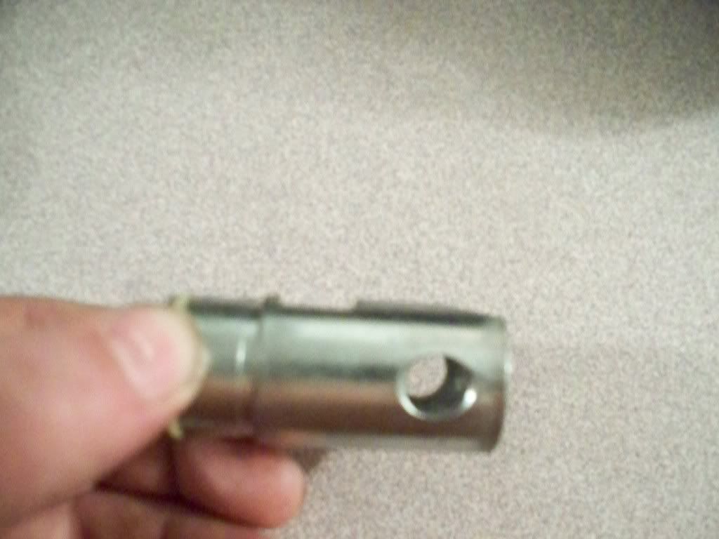

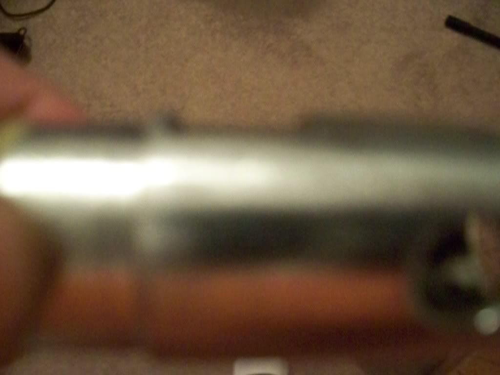

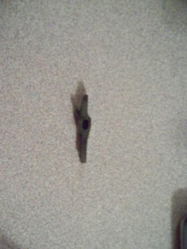

#26 zephaniah
zephaniah
  • 135 posts
Posted 19 February 2012 - 09:35 PM
Posted Image Posted Image Posted Image Posted Image
not the best pics, from what i can tell, for the age and amount of time i've used it, doesnt seem bad,

#27 TinyBear
TinyBear
  • 745 posts
  • Location:Ontario Canada
Posted 19 February 2012 - 09:58 PM
Hmm hard to tell but yeah dont look too bad. The sear looks a bit wierd but not too sure (been a long time sice i had my 98). But tomorrow i will pull apart my carbine and A5 for comparison. my a5 is relitivly new my carbine has over a decade of HARD use so i compare the two and get back to ya.
How the spring for the sear holding up? maybe it is not resetting the sear back into place in time for the hammer to catch it? Never seen that before but now i kinda guessing to be honest .
I mean tippmanns are pretty simple little guns its not making sence to me. If ya cycling fine at slow rates of fire but start to mis catch at higher rates of fire i doubt its a valve issue (you dont hear any leaks either right?). so it leading me to belive it a mechanics issue and really only mechanics that can cause this issue is Valve mounting, hammer oring, hammer/sear/sear spring interaction.
#28 zephaniah
zephaniah
  • 135 posts
Posted 19 February 2012 - 10:13 PM
the spring is stiff, i wish the camera i used had a little clearer picture,
it doesnt make sense to me either

Sear is worn. If you pull it out and look at it, if its "rounded" near the edge instead of a sharp cut. Then its worn.
You can go to pretty much any field and ask the owner if you can grab a new sear off his back table for a toonie or something. Most fields will have at least 30 Extra brand new sears for tippy 98's.
Actually ask em if you can just grab a new sear, new mainspring and if your bolt is all chewed up from use one of those too :)

just took a closer look myself, the edge of the sear that would catch on the hammer is slightly rounded, dragging a finger over it, it doesnt feel sharp, same time, the back ledge of the hammer is the same way, so i think the combo of the 2 is makin it worse, both parts are cheap
