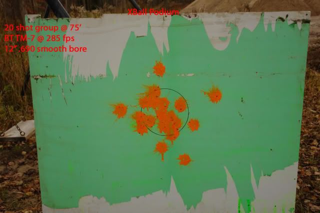

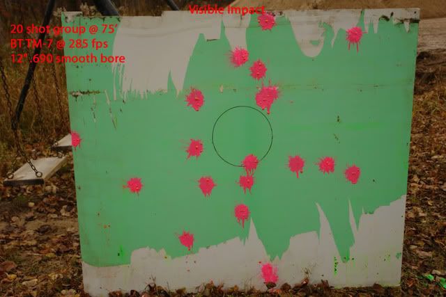

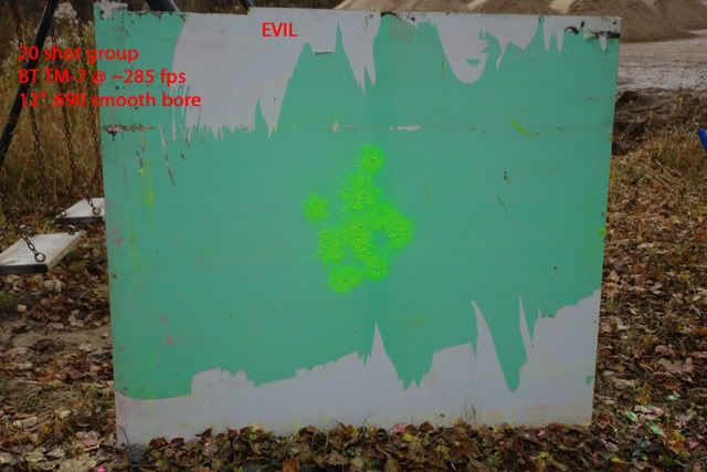

I just conducted some analysis of rntlee's paintball data. Here's the processed data (sorted by sectional density):
Brand Avg Diam / Weight / SD / 'eccentricity'
Visible Impact .670 / 3.40g / .0167 / .030
DXS Triumph .665 / 3.32g / .0166 / .030
Xball .678 / 3.44g / .0165 / .015
DXS Field .670 / 3.36g / .0165 / .030
Marbs .670 / 3.08g / .0151 / .030
Evil .679 / 3.08g / .0147 / .010
SD = Sectional Density, higher numbers are better
eccentricity = difference between the cross seam diameter and the seam diameter, smaller numbers are better.
I find it a bit interesting that the least dense paint in the roundup was the roundest. I also found it interesting that the heaviest paint was second largest.
I strongly suspect that shrinking paint sizes have little if nothing to do with trying to improve things for us.

It's interesting that the list is coincidentally also ordered by performance, with worst at the top....

I suspected as much given the roundness of the Evil. How did the X-ball perform? How were the seams?
Here's a few comparison pics of the groups for reference.
Worst to best as in your list:
I was able to bring the poor performers up to roughly the same performance as Evil by scraping their seams smooth...so the fill itself doesn't seem to contribute much spread at the distance I was shooting here (75').

One other thing to note:
These pics were all taken with roughly the same time interval after shooting. You can see that the Evil fill does not flow like the others, even though it's the least dense.
Edit: I should also add that the new Visible Impact with the striped shell is not as poor as this older type (orange shell), probably closer to the Xball now. These pics are a few years old.

UV- Halo, Thank You for the is great ballistic data, obviously a superior brain - As is shown in these physics calculations, sectional density make an enormous difference. Drop difference of about 10 feet @ a range of 75 ft. Wind deflection difference of several feet @ a range of 60 feet, with a very light wind....WOW.
These are giant differences in the field.
MTLEE - thank you for the target data, great work - I agree with your assessment, what is clear from the targets, the quality of the seam far out weights the the difference of the fill viscosities when it come to the size of the groups.
It seems to me getting the fill nearer the maximum weight and maintaing the roundness and smoothness (as defined as an absence of a pronounced seam), would seem to give us the best performance. So the manufacturer that wants to make a better paintball, need to find a fill that is heavier(denser) than PEG-8, and still has the other characteristics needed; safe, inexpensive, non-solvating to gelatin, easy to clean off, available, etc.. and put it in a good quality shell. Looks like RPS still has some room for improvement and can make Evil even better. This answers another thread is saw, "have we reached the technological limits of paintball?" - the answer is "NO".
It may be worth noting that Ultra evil is heavier. The batch I have on hand is coming in around 3.2g at a .6775" median axis, and this is the scented one which appears to have more oil than the unscented.
However none of this takes into account a very important aspect of paintball performance: marking ability. An extremely viscous, heavy paint may not mark very well. Splat size will be restricted and you may actually get "fly off" problems. The best ballistics is meaningless if you don't get a mark on your target.
There are some brands going around with the consistency of snot, and paints like Infinity are extremely waxy. They don't mark anywhere near as well as higher-quality, better-flowing, lighter paints.
Keep your pump hand strong!

No problem! I wouldn't say I have a superior brain, I just had the right know-how and data at the right time. However I must inform you that there's one more correction to your remarks :)
On my charts, vertical columns (Y-axis) are in inches, while the horizontal scale is in yards. So, at 75ft (25yds), there is a drop difference close to 10".
Interesting that Ultra-Evil is so much heavier. Assuming it has the same quality of seams and roundness; it looks like it could be a real upgrade from Evil. May be the best paint available?
As for the marking abilities of thickened paint, it has more to do with the rheology that just viscosity. Something waxy has a more Newtonian rheology, what you want in a paintball fill is something that is thixotropic and pseudoplastic
If something has Newtonian rheology, it will maintain its viscosity regardless of the shear applied to it. If something is thixotropic, it is thick as rest, and then thins out when energy is applied. Pseudoplastic means that when the energy is removed, the viscosity recovers.
Think of this as Honey and Mayonnaise; The Honey is pourable (lower viscosity), but hard to spread and stir, a capsule filled with honey would leave a small mark. At a given temperature, Honey exhibits Newtonian properties. Mayonaise is not pourable (higher viscosity), yet easy to spread and stir (thixotropic), but recovers to it resting viscosity quickly (pseudoplastic) - a capsule filled with mayonnaise would leave a bigger mark.
