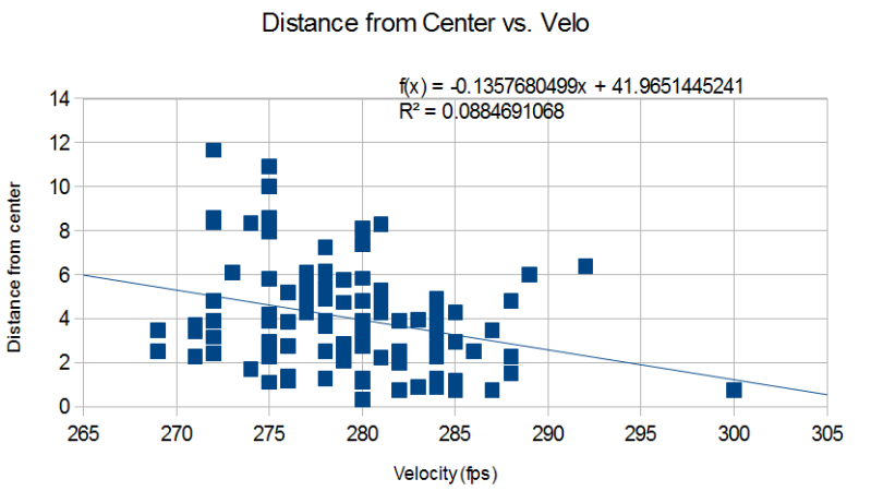

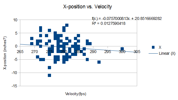

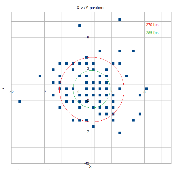

I have a large data set of recorded shots (103 shot @ 75') that I broke down a bit. Nothing really new but it does confirm consistency must be quite poor to affect accuracy much at medium range.
Here's the original group and underneath it just the shots within +-2fps
Here's just the shot >= +-5fps

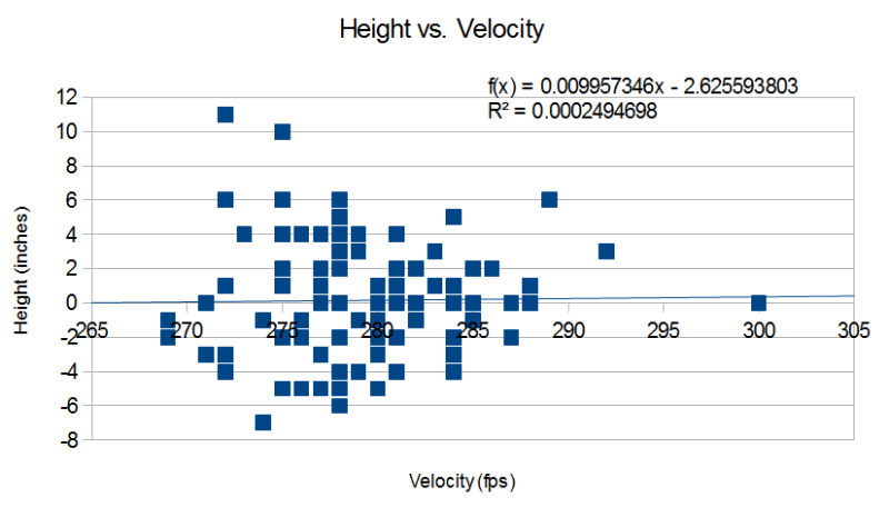

I took the liberty of graphing shot velocity verses height:
Within the given dataset, the trendline that maps this data has a coefficient of determination (r^2) of .0004 (where 1 is a perfect line) Just to give you an idea as to what a GOOD r^2 value is, I frequently threw out data that was worse than .96 when I worked in a lab. I can say with a VERY high level of confidence, within this dataset, there is no correlation between shot velocity and impact height.

So I did a little more digging, and decided that even with 100 shots the statistics were still not good enough to make a solid conclusion. Here's a graph of the distance from the average center vs. velocity:
It looked to me like the shots that were at a higher velocity tended to be more accurate, so I broke things down into velocity groups to get a better picture of what was going on.
If we ignore the first and last columns (the first has only 5 datapoints and the last 6, not enough to get a good picture) we can see that as the velocity increases, the average distance to the average center decreases. Also, as velocity increases, the spread (less strongly) seems to decrease.
Since we've already seen that the increase in distance from center is not a result of velocity fluctuations causing the ball to fall short, this data seems to support my hypothesis that more energy used to spin the ball results in lower translational velocity, and also causes a larger spread (in any direction)
It also makes me wonder about his bore, paint size and paint quality.

Egomaniacal, with all due respect, the coefficient of determination on that data set is crap. You can't draw any relevant conclusions with a value of .08.

Alright, time to squash this coefficient of determination thing once and for all.
Troy,
This is why I threw the linear regression out. There's more than one way to analyze a set of data, and frankly just looking at r^2 tells us bupkis about whether or not there is a relationship between measured quantities. It is one of the many massively misleading things people are taught in K-12 math/science classes.
Frankly, for ANYTHING on this site, in my opinion you guys should almost never use r^2 as a determining factor of whether two things depend on each other. You guys do a thousand times better than anyone else out there, but there is just too much noise in the systems you're trying to measure and your sample sizes are too small to throw things out for not having r^2 >= 0.9.
Goodness of fit (R-squared) and trend
The least-squares fitting process produces a value – r-squared (r2) – which is the square of the residuals of the data after the fit. It says what fraction of the variance of the data is explained by the fitted trend line. It does not relate to the statistical significance of the trend line (see graph); statistical significance of the trend is determined by its t-statistic. A noisy series can have a very low r2 value but a very high significance in a test for the presence of trend. Often, filtering a series increases r2 while making little difference to the fitted trend or significance. In a method for identifying a statistically meaningful trend, only filtered or unfiltered series with r2 values exceeding 0.65 are counted as positive test results.
Again I would like to say that this is a fantastic data set. Thank you rntlee for taking it, the work must have been painstaking. That said, I would have loved for it to be 10,000 shots. :P
At any rate, instead of having 103 distinct data points to work with, I grouped them into 5 or so points each with an associated spread in the measurement - a perfectly legitimate step to take. By doing so, we can see that there is a very strongly suggested negatively correlated trend in the data. Note that I have not accounted for experimental uncertainties here, the SD is due to the randomness of events alone. This averaging is a form of discrete filter, and if we eliminate the first datapoint due to its low sample size for the filter the trend on this graph has an r^2 = 0.86.
So I decided this would be a good time to brush off the old statistics courses I thought I was wasting time in. Going back to the original data with n=103, (I did not want to exclude data due to the incompetence of my filter), we have:
Null hypothesis: There is no correlation between distance from the center and velocity, meaning the slope of the regression is not statistically significantly different from 0.
Doing this, I calculated a standard deviation in the slope of this regression of 0.044, and a t-score of -3.074 (the negative sign indicating the negative slope). Combining that with 101 degrees of freedom (as you would for a simple linear regression), I get a p-value of p=0.0014 (makes sense, slope was -.13 and error was .004). This is statistically significant by any standard, so using a slope from the regression of -0.13, we reject the null hypothesis and therefore can say without doubt there is a correlation between the average distance from center and velocity.
Next, I figured I'd check to see if there was a statistically significant correlation between velocity and height.
Null hypothesis: There is no correlation between height and velocity, meaning the slope of the regression is not statistically different from 0.
I calculated a standard error in the slope of this regression at .0076, and a t-score of 1.305. Again with 101 degrees of freedom our p-value is p=.19, so it is not statistically significant and we cannot reject the null hypothesis with this dataset (again this makes sense, slope was .009 and error was .007). We see that any range effects due to velocity over this velocity range are wiped out completely by other causes of inaccuracy.
If you want to follow what I've done I used the method straight off of Wikipedia, but it agrees with what I've previously learned (and the notes I was looking through).
http://en.wikipedia....near_regressionhttp://en.wikipedia....near_regression
I suppose the correct thing to do would have been to re-do the filter to be more rigorous, then done the t-test on the fit from that. That way from the same set of data we would have both r^2>=.65 and statistical significance, but I'm done, and looking at these results I don't feel it necessary to go back and do that. To point out why,
I just re-did the filter with a commonly used discrete filter, taking an average of every 10 shots (threw out the first two and the last one). With this, I still get r^2 = .687 and a slope of b = -0.135.
Ah fuck it, might as well do it.
n = 10
Standard error in slope: 0.03366
t-value: -4.00
p-value: .0039
So doing it completely rigorously we have r^2 = .687 and strong statistical significance.
Troy, I want to thank you for giving me a reason to review this material. It was a great afternoon.

#32 Egomaniacal
Egomaniacal
  • 139 posts
  • Location:Maryland
Posted 22 May 2012 - 02:55 PM
now, i would hardly say the link between distance from center and velocity is a strong trend (a trend maybe, but not a very strong one)
Now I won't argue that the signal isn't muddy (clearly there are confounding factors), but the correlation here is really undeniable. It is extremely strong, with p < 0.01. Whether or not addressing this issue translates to an increase in accuracy on the field is certainly up for debate - but you can't claim the trend isn't strong.
I like that idea. If it's true, then it sounds like an ideal candidate for a dual crono test. Test the velocity right out of an underbored barrel, then downrange slightly, and see if the shots with the greatest delta are the most inaccurate. Hmmm... maybe I can rope someone else into a test that has another crono.
Really you'd want to test the velo before it left the barrel... I'm not sure that's feasible.
Also, as I went back to re-do the data for the x position, I realized I missed a ^2 term in the y position (but not distance - don't worry, I checked). Doesn't change the graph, but it increased the standard error in the fitted slope significantly and therefore the p-value went up.
Re-doing the data, I get:
Distance vs. Velocity:
Slope of fit: -0.1357680499
Standard Error in Slope: 0.0442434247
t= -3.0739030954
p=0.0027
Filtered Distance vs. Velocity:
Slope of fit: -0.1346926127
SE in slope: 0.0336635037
t= -4.0010689732
p= 0.0039
Y-position vs. Velocity
Slope of fit: 0.009957346
Standard Error in Slope: 0.0624854301
t= 0.1593546846
p= 0.8737
X-position vs. Velocity
Slope of fit: -0.0757000813
SE in slope: 0.4750982509
t= -0.1593354635
p= 0.8737
As you can see, with the revised calculation the fit in the y-direction is even worse than before. What was stunning to me was that the t-score for the fit in both the x and y directions are identical to the 10,000ths place - telling us the lack of correlation is nearly identical in both directions over the entire dataset. Interesting implications there for range. Don't worry, I double checked them and encourage you to do the same - it's a two tailed t-test, and you can get the t-value by dividing the slope of the fit by the standard error - remarkable that such different slopes give nearly identical t-test numbers due to the uncertainty calculation.
At any rate, here's the graph for the x-position
Next I'm going to see if I can come up with a way to quantify an increase in the spread of data, instead of looking at the increase in mean distance from center.
Edited by Egomaniacal, 22 May 2012 - 02:58 PM.

#33 cockerpunk
cockerpunk
    All the Dudes
  • 9,137 posts
Posted 22 May 2012 - 03:13 PM
what im saying is the trend is not a very large one. a major increase in one does not have a very large effect on the other. im not denying a trend, im saying its a small trend.

#36 Egomaniacal
Egomaniacal
  • 139 posts
  • Location:Maryland
Posted 22 May 2012 - 04:09 PM
Ah, right. As it stands the trend says the mean distance from center increases by 0.13" per fps lost, which doesn't seem trivial to me. But keep in mind as well that's the change in mean distance from the center - so it's in the radial direction only. So if you were to look across your shot pattern it's a quarter inch per fps, and suddenly it's not so trivial - and again this is just the average distance from the center, so we're loosing a lot of information about how much the distribution smears out as velocity drops. Still working on figuring out a rigorous way to examine that.
Edited by Egomaniacal, 22 May 2012 - 04:16 PM.

#40 cockerpunk
cockerpunk
    All the Dudes
  • 9,137 posts
Posted 23 May 2012 - 09:36 AM
no, its still .13" per FPS ... how are you getting a quarter inch?

#42 Troy
Troy
    What... is the air-speed velocity of an unladen swallow?
  • 896 posts
  • Location:Oklahoma City
Posted 23 May 2012 - 10:33 AM
I believe what he's saying is that since the vector length is a radius, a vector of .13" would cause a shot spread of .26" in diameter.

#43 Egomaniacal
Egomaniacal
  • 139 posts
  • Location:Maryland
Posted 23 May 2012 - 11:14 AM
Gordon -
Here's a plot of what the velocity correlation gives us. At 270 fps, r=2.75 inches and at 285 fps r = 4.8 inches. Again, remember this is a trend of the average distance to the center of the grouping.
That doesn't seem like a small change to me.
Edited by Egomaniacal, 23 May 2012 - 11:26 AM.
