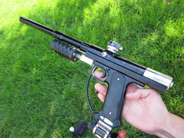

This is the beaut that Stick loves:

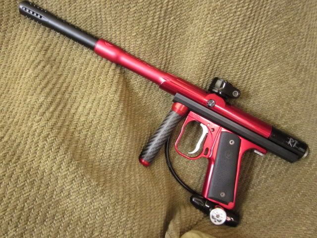

Forget the red mag, how does that mag pump shoot?

The first picture is the only pump mag shown.
The second is a Minimag body with a E-mag valve and a Y-Frame grip

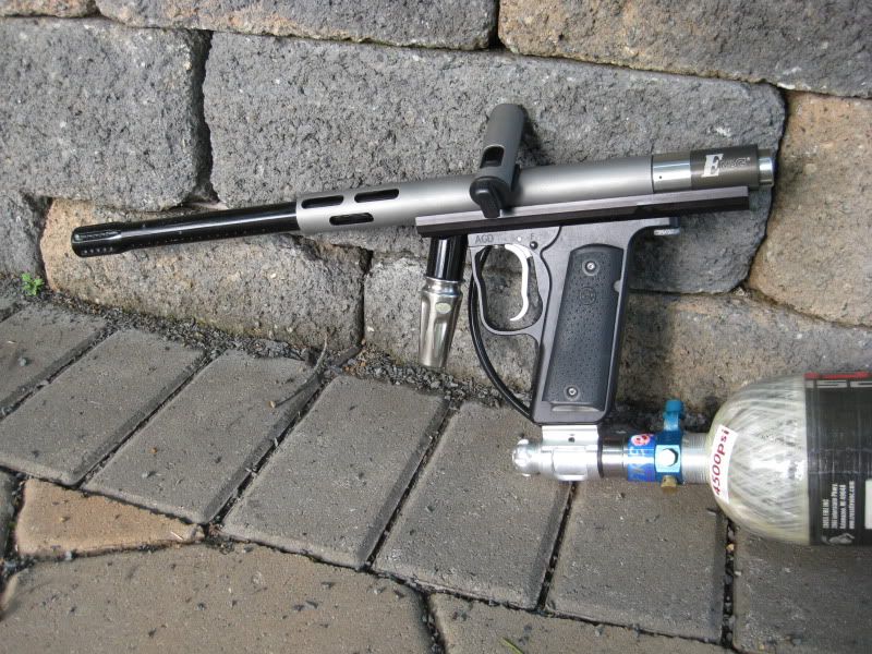

The third is ULE Body with a RT Pro X-Valve on it and a standard Intelli-frame grip.
Incredibly well. The pump stroke is almost nothing, and you can use any barrel you want. Because it's an open bolt pump you can rely on your detents. If you don't feel like playing pump for the day, all you have to do is pull out the wave spring, et voila, you have an automag you can shoot in semi.
