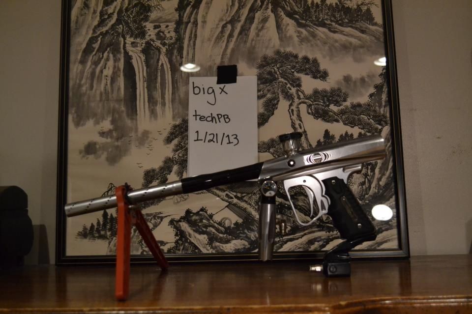

Marker: Smart Parts SFT Shocker "Pending to Schuler"
Color: Silver
Condition 7/10 Functionality 10/10 "WITH NEW UPPER BOARD"
Known Problems: Needs New Upper Board MARKER IS CURRENTLY NON FUNCTIONAL
Upgrades: CCM Feedneck, NDZ Sprung Bolt and Can, Black Heart Board, Virtue Board "Needs Repair"
What is Included: Gun, Barrel, All Upgrades Listed, Stock Bolt and Can, O Ring Rebuild Kit

I took it to the indoor field yesterday and shot it. At first I was scared because I wouldn't shoot and the air sound like it was coming out the noid. So is put it down and thought to my self that I would just mess with it then I get home. I started talking to my team mate and he wanted to see what was going on with it. Put it air in the gun it not only shot. It Also had no leaks.( I pray to the Pb god) I use it the rest of the afternoon.
The biggest problem with it was huge spikes in volicity like 190 190 194 185 320. I'm guess it the reg. also the field I play at is close Quarters reball so all guns are turn down to 220. With that being said what do y'all think it might be.
#45 nighthunter
nighthunter
  • 4,104 posts
Posted 10 March 2013 - 05:06 PM
Make sure your bolt kit is well-lubed with no damaged o-rings, and consider servicing your reg.
What paint were you using? If the paint was kinda nasty, it could have caused the velocity fluctuations.

Reballs are notoriously tiny, and if they weren't 100% clean, they could conceivably cause some issues. I'd give everything a nice lube job just to be sure, though.

I did. The gun is running just as good as before. Plus the reg was a little gunked up

I got another shocker. Came in today. So the Asa reg and noid need to be cHanged. I also need to buy a Vertical adapter, so I can have a normal reg. by any chance can nxt vertical adapter fit with a little mod. If so is their any that would be willing to do it for me because I don't want to mess it up.
#50 nighthunter
nighthunter
  • 4,104 posts
Posted 13 March 2013 - 04:43 PM
Wait, it came with the old school horizontal Max-flo reg? that's REALLY old school there.
Anyway, the NXT vert asa is not in any way backwards compatible with the SFT Vert asa. (although the SFT VA is forward compatible and can work on an NXT.) It would take quite a bit of effort to alter the NXT VA, because the screw that holds it in is located in a different place, and it won't really fit well.
I'm not sure if you can still find them new (except maybe on Ebay,) but if you contact the folks at Shockerrepair.com, they nearly always have the extra parts you'll need. (The guy who runs Shockerrepair goes by "fishballer" on PBN, so if you don't get a fast response from the main site, you can PM him. Edit: he also usually has a spare noid or two.
