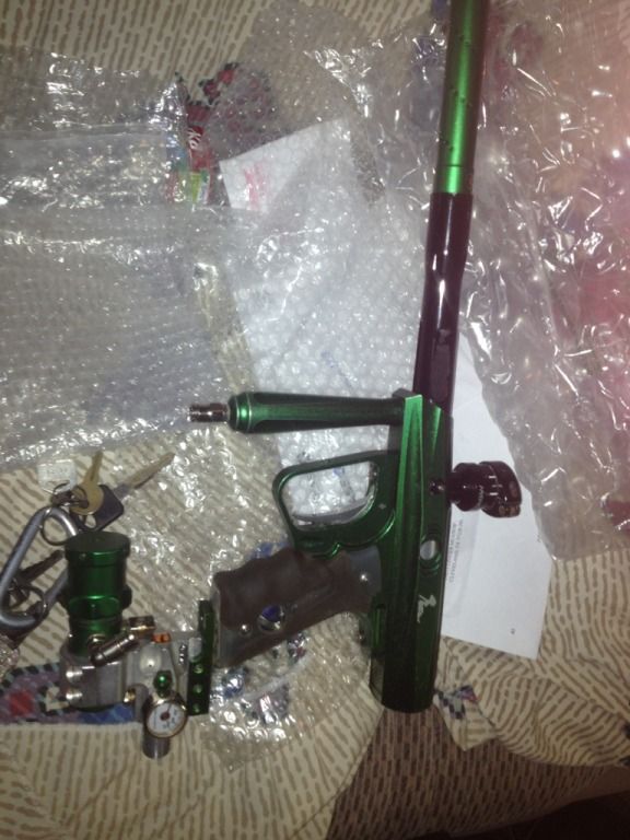

I figured out what was wrong with both my silver and green shockers. The green one has damage to the upper board and it's a Parker noid.
The silver one, the wire hareness was loose in the board. I changed out the board and put it back together. The only problem now is the power button isn't making contact to the upper board. How do I fix that.

#78 SCHULER
SCHULER
  • 1,363 posts
  • Location:cleveland,tx
Posted 20 March 2013 - 02:01 AM

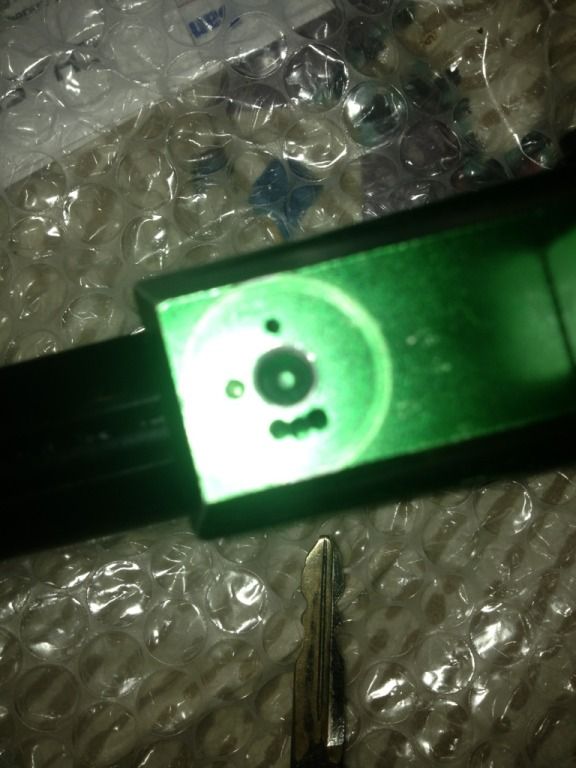

Green shocker noid

The above noid as you probably know is a parker noid. If you're good at soldering, you can take the contact clips off of a humphrey upper board (they are easy to find) then de-solder the old upper board from the contacts on the noid, and carefully solder the new one on.
I've done this before, and it's a pain, but it works.
This is assuming you have a broken upper board..... If the board is fine, that process ^^^ is obviously not necessary.

Well the pic is the show that the upper board was crushed by the grip screw. Also I found Parker upper board for sell for 20 in a few places.
