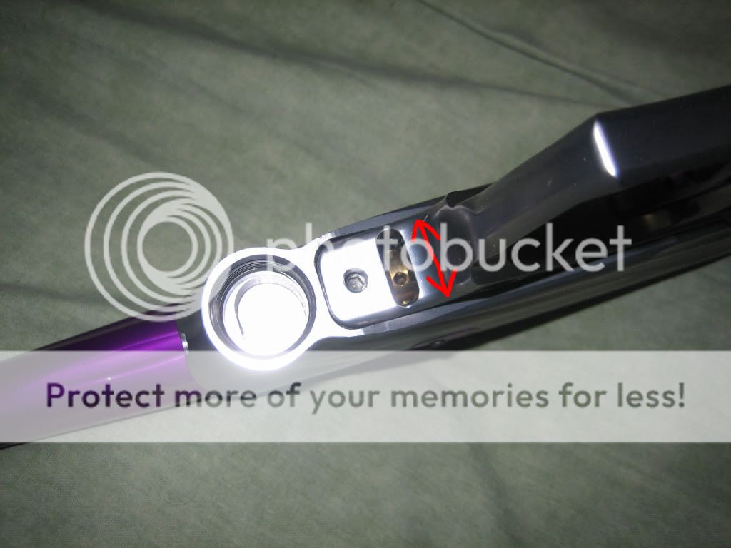

Are you referring to the set screws on the top of the high pressure reg that goes into the gun?
Look at the bottom of your grip frame, in front of the trigger guard. Is there a little slot milled in the frame?
This is where you adjust the LPR:
Edited by andrewthewookie, 26 February 2013 - 08:48 PM.

Yes those screws. And that slot in front of the trigger guard is how I was adjusting the lpr. I know those 2 set screws an the hpr only alow you to twist the macro fitting out of the way so you can access the lpr through that slot without removing the grip frame.
Yes I have that slot.
