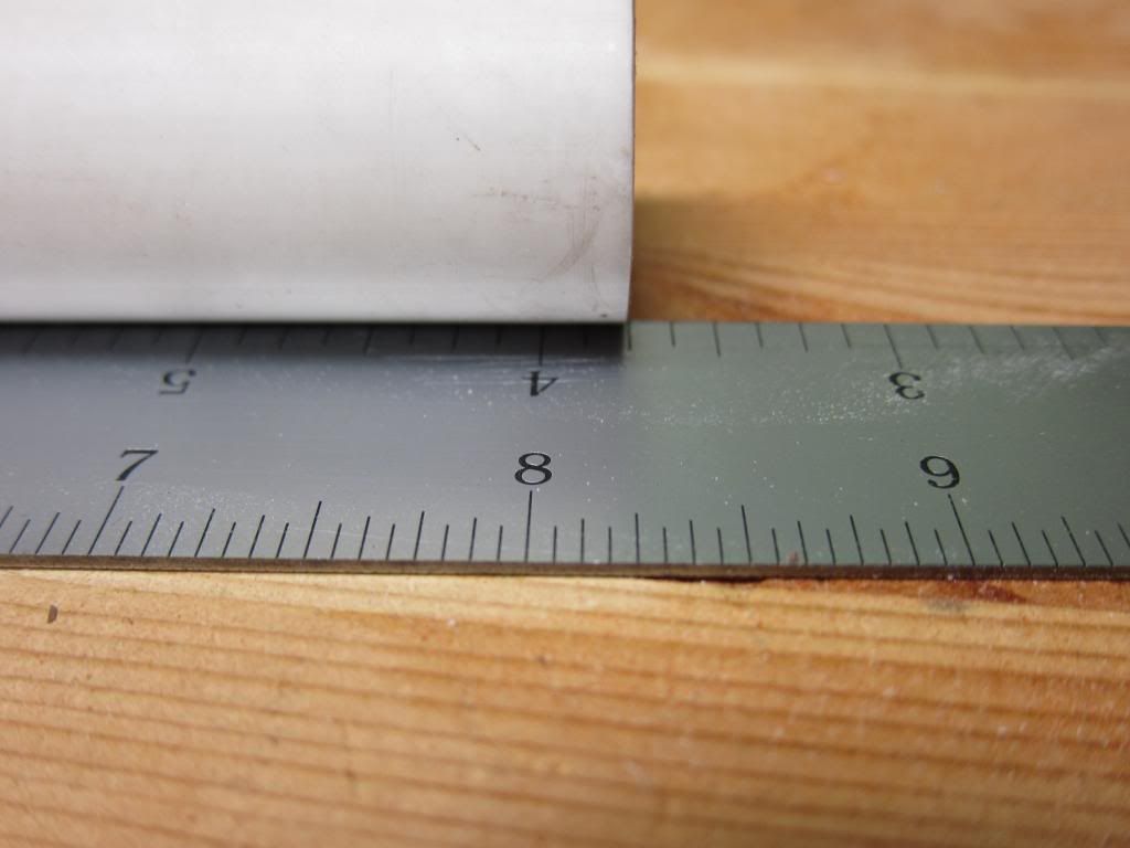

Next I figured out that the pipe was too thick to fit in the feedneck so I had to sand it down to make it fit.
Comparison of sanded down pipe that goes into the feedneck and a non sanded down pipe:
I started with 60 grit and moved my way up to 400 grit

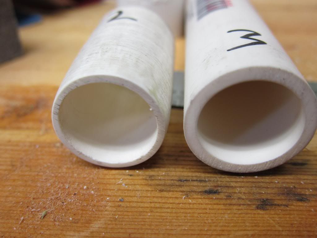

Next I started to sand the inside of the pipe to make it smooth and flush when it is in the elbow so the balls can just roll through and not bump into the wall. Here is the comparison of a no sanded down pipe.
It is really smooth on the wall of the elbow, the picture does not do it justice.

#2 gets shaved on the inside of the pipe to get it flush with the wall on the elbow
#3 is not touched
