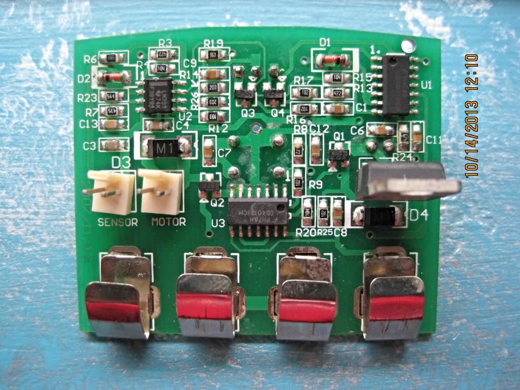

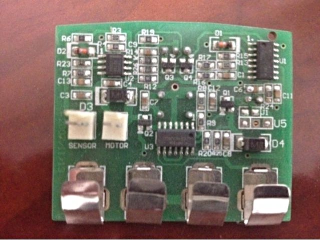

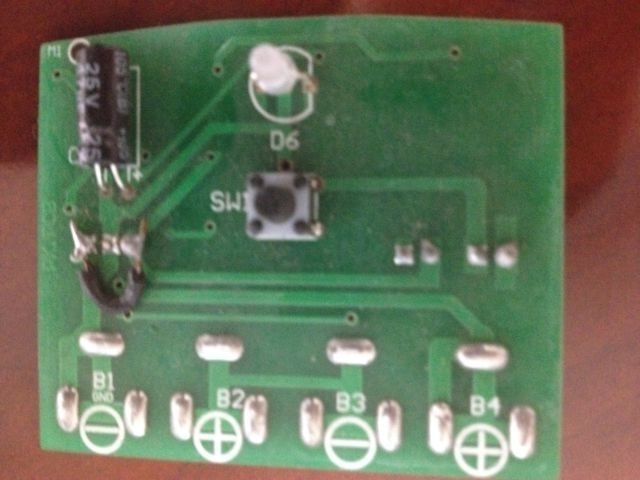

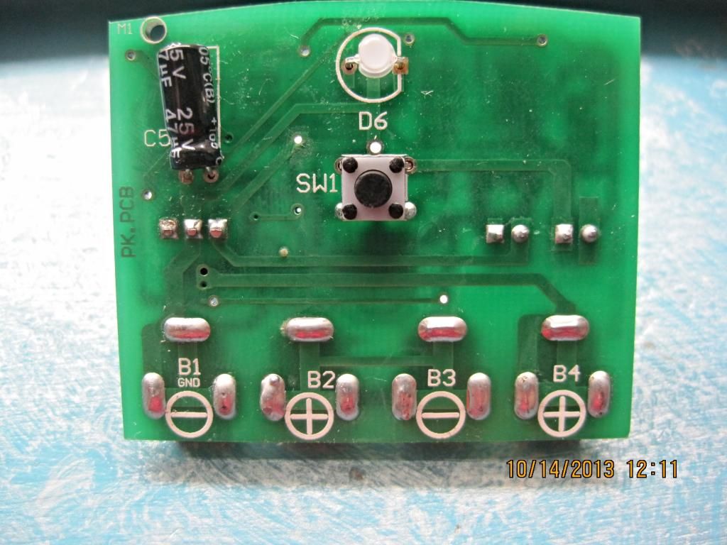

if you have electronic skills this mod is almost free
you wont loose your board for days
now if you do this pinokio will void your warranty and if you mess up the board, you will need to buy a
new one so this mod is up to you
will drain batts faster
you need to remove the voltage regulator chip
use a shop vac to remove the weld
then use a wire to bridge it
this will allow the full batt voltage to the motor
stock board pics
17 secnds 200 reballs
p board pics
9 seconds reballs
I hope this helps

I'd advise against this, you're basically changing the amount of voltage the circuit receives. The purpose of a regulator isn't just to drop the voltage down from 18v it also serves to prevent any spikes and it limits current draw. This allows consistent feeding of balls by ensuring constant motor speed. By removing that regulator you're drastically shortening the life of your motors and board.
I would assume that a PBoard uses different components
