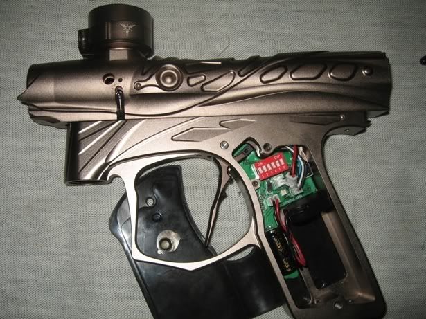

In some of the pictures you will notice that I have the frame removed from the body. This isn't needed. I just happen to have the body separated at the time.

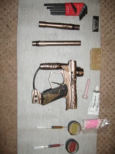

Tools needed:
3/16 allen wrench
50/50 mix Equal parts dow33 and Gold Cup
Dental tool or O-ring pick set
Rag

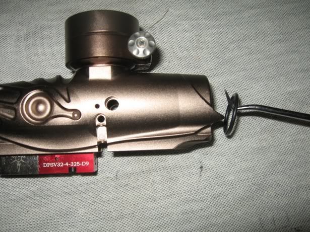

Step #1 As you can see in the picture. A clean work area makes the job easy and makes it less likely that pieces and O-ring will be misplaced. The threshold marker was designed to be stripped, cleaned, and put back together, at the field, easily and within only a couple minutes.

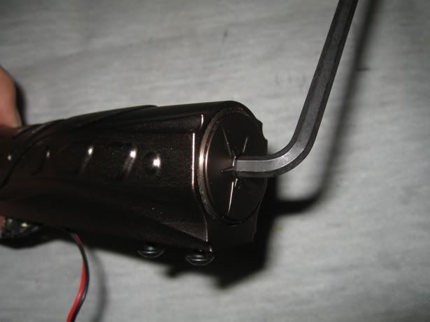

Step #2 Unscrew the back cap counter clockwise, using the 3/16 allen wrench included with your marker.
Step #3
Shown is the complete assembly of the bolt, body, and back cap.

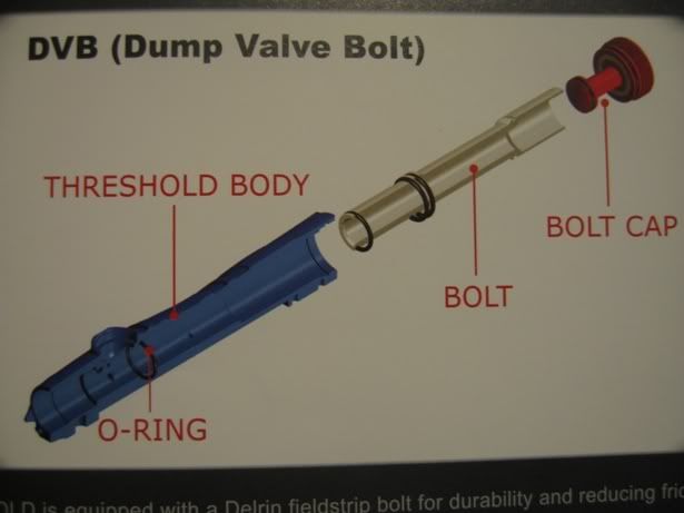

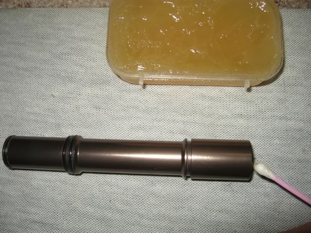

Step #4 Remove the bolt from the body and wipe the bolt and O-ring clean. Don't forget to clean the inside rear of the bolt with the rag also. Replace any damaged O-ring and then reapply the 50/50 mix lube on the 3 O-rings, located at the front of the bolt. Notice that it doesn't take much. Too much lube will cause FSDO (first shot drop off), or bolt stick. I also lube the bolt in this area so that it will lube the internal O-ring in the body when the bolts replaced. The outside of the bolt doesn't need lube anywhere else.

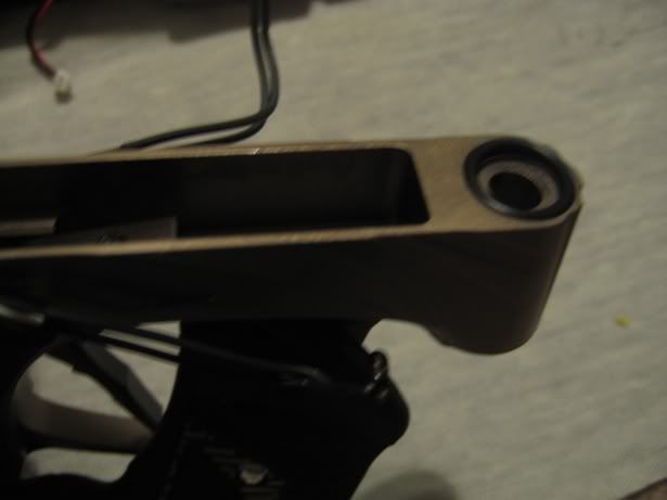

At this time you should clean in internals of the body. Just wipe clean what you can reach with the rag. The front chamber, feedneck, and barrel threads should be wiped clean. If you have had a ball beak in the chamber, the eye covers should be removed, using the 5/64 allen wrench. Use the pick to aid in the separation on the eyes and eye wires from the body. Be careful with the eye wires. Clean the eyes, dents, and eye covers from all paint before replacing them on the body. The dents don't need to be lubed.

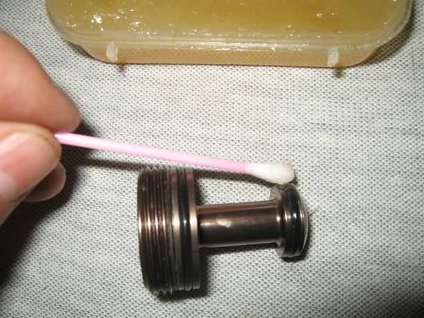

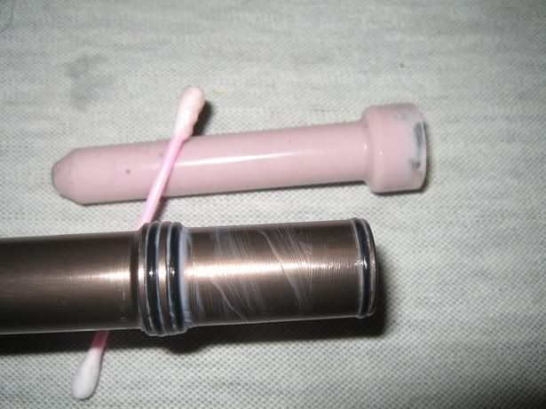

Step #5 I use slick honey on these next couple areas, but the 50/50 mix will work. The Slickhoney needs only a film on the internal of the rear of the bolt. Too much and it'll cause problems. It will last longer and is slicker than any other lube that I've found. You can even skip this step and just apply it to the back cap O-ring as seen in the next step.
Step #6
After wiping all the dirty lube from the back cap and it's O-rings, reapply fresh clean lube. Don't forget to lube the back cap sealing O-ring located next to the threaded area that screws into the body. Just a light coat will do. If your back cap comes loose while shooting, it's most likely due to this O-ring. If the cap does come loose, a swelling lube like dow55 will help.

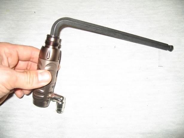

Step #1 Loosen the HPR by turning it counterclockwise by hand or strap wrench. If you don't have a strap wrench, a wet towel or even a computer mouse pad will give you a better grip when unscrewing this by hand.
Step #2 If you can't remove the top of the HPR by hand, you can use either a 3/8" allen wrench (as shown)to loosen it. This allen wrench is not supplied with the Threshold and will have to be purchased separately. An alternative is to use the strap wrench, wet towel, or even a computer mouse pad to help you removed the HPR with.
Here's a little trick. Use the 1/4 allen wrench in combination with 1/8 allen wrench to loosen the top portion of the HPR. Simply put them side by side and use the same way as the 3/8 allen wrench.

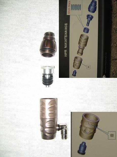

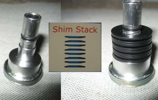

Step#4 Once the piston is out the assembly, it should look like this. Clean off all O-rings and wipe all surfaces clean. Replace any damaged O-rings.
Step#5 There are 4 O-rings that need to be lubed occasionally on the HPR assembly.
2 of the O-rings you can see in this last picture on the piston need to be lubed with a thick lube. I like Voltagepb blood lube for these O-rings since it lasts much longer then Dow55 and also swells the O-rings, but you can use any lube you have on hand.
Dow 55 or a swelling lube should be used on the 2 O-rings on the top portion of the HPR when reassembling.
In the top left of the piston picture you will see a black area. This is the regulator seat. This little guy can cause problems so don't forget to inspect it for any damage. I apologize for not having a better picture of it, but Xluben will have better pictures of the regulator seat in his tutorial on the G3
Last but not least. Pay close attention to the # and order of the shim stack.

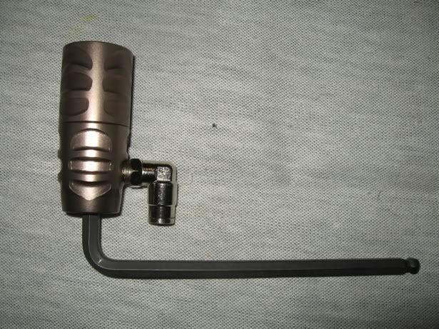

*Here’s something to save you some grief with putting you’re micro lines into the elbows.
Taper/round the end of the macro fitting slightly. In the picture I just cut it with a razor blade. It makes inserting the macro much easier and holds just as well as leaving it at a 90* angle.

This will help anyone needing to add a trigger rendition kit, service the solenoid, or troubleshoot a leak between the frame and body. If you still have your HPR attached you will need to remove that first. Use a strap wrench to remove the HPR before beginning.

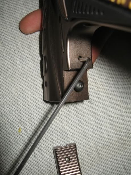

Step #1 Remove the grip screws from the left side of the grip frame using the 3/32 allen wrench. You can remove both sides, but it's not necessary.
Also remove the Eye covers on both sides using the 5/64 allen wrench.
Step #2

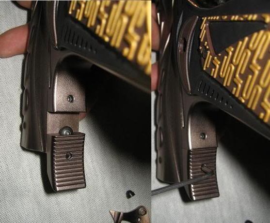

Loosen the snatch grip's hidden screw with the 3/32 allen wrench. 1/2 – 3/4 turn is all it takes. There is no need to remove the screw. Then simply slide off the snatch grip.
Step #3 Loosen the grip frame's hidden screw the same way you did the snatch grip. Remember you only need to loosen it.

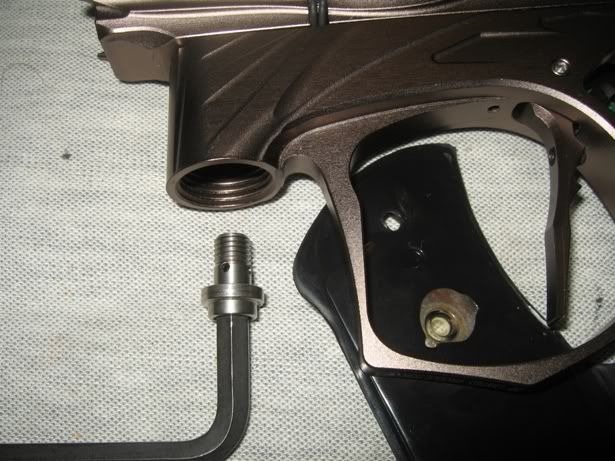

Step #4 Remove the Screw in the front of the marker where the HPR was mounted, using the 1/4 allen wrench.

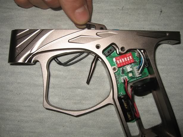

Step #5 Time to unplug the solenoid connector from the circuit board using the pliers. Grab only the top half of the connecter when doing this. Do this carefully so you don't bend the pins or damage the connector. Sometimes the whole connecter will slide off the pins. That's okay. Just separate the connector's pieces and slide the bottom/receiving end back on the pins. Be sure to do it carefully so you don't damage the pins
Step #6 The grip frame should now be able to slide about 1/2 inch rearward on the body. You should then be able to separate the frame and body easily. Be careful with the solenoid connector snagging on any other wires when separating the body and frame. The eyes should be removed from the body at this time. Notice that the eye wires run on one side of the solenoid when separating. This is how you will need it to run them inside the frame when you put it back together, or it can interfere with the trigger.
Step #7 The O-ring in the picture is the one you will need to put the Dow55 on. This O-ring will nearly never need to be changed. If there is a leak in that area and that O-ring is suspected to be damaged, it's more likely to be the front frame screw not being tight enough. Make sure that the O-ring is in its proper place before remounting the frame to body.

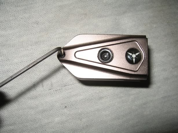

Since the frame screws are hidden inside the frame. If you strip one or both of the screws when trying to remove them, here's something that might help.
Put some superglue on the tip of your allen wrench head and insert it through the hole so it makes contact with the allen screw. Let it dry. It will sometimes work with superglue and if your lucky it'll work for you. A more extreme stripped screw, you could use JBweld or some other epoxy to do the same thing. However, please use more caution if you do. If you use epoxies, there is a greater chance of glueing something together that you don't want. If your hesitant about doing this, don't! Call DP and allow professions to handle it. If you do do this. Make sur that you glue it and then have enough room to unscrew it. ;)

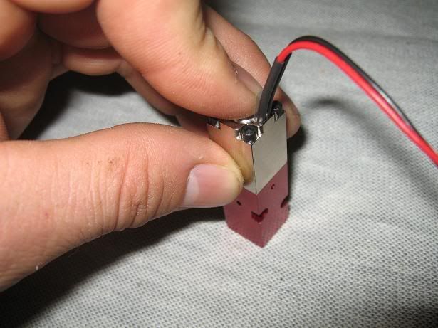

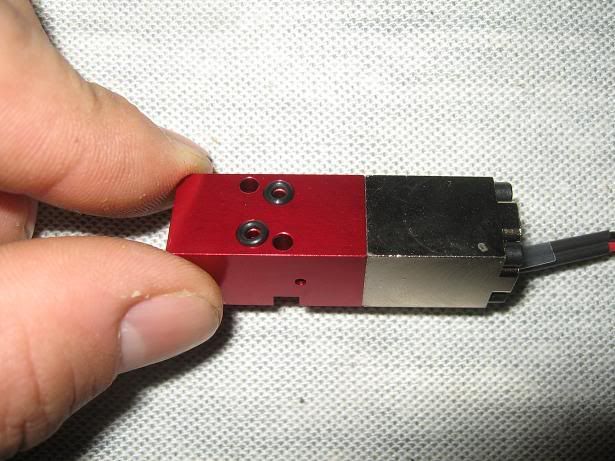

Step #1 First, unscrew the 2 mounting screws securing the solenoid to the body. These screws have very small threads and, if over tightened, can strip very easily.
Step #2 Remove the 2 O-rings that seal the solenoid to the body and place them in a bag or safe place. These are small and can be lost very easily.
Step#3 Time to use that screwdriver. The screw driver I'm using is a 5/32 flat head screw driver. You can use another size screw driver just as long as it fits the screw's width. If you use too small of a screw driver; the screw will be harder to unscrew, can damage the screw head, and possibly strip the screw's head. This screw can be very tight and being on such a small object, can be difficult to loosen just by holding the solenoid. If you can't unscrew it by holding it, you can use a vice. Be sure to put something on the sides of the solenoid as to not damage it. You can also use vice grips, but as before, protect the solenoid from any metal device holding it! Leather is great to use.
DON'T TOUCH THIS SIDE! Here is another picture, but of the wrong side! You don't need to open this side for anything ever. Notice the Hex head/Allen screws on this side? If you touch those screws and separate the halves of the solenoid, say bye-bye to your warranty! Unless instructed by Dangerous Power, leave this side alone.
Here you can see what it will look like after you remove the screw.
Step #4 Welcome to the most frustrating part of the solenoid. Depending on the condition of the O-rings, lube, and piston, this can be a pain in the…:crash: First remove the spring and set it aside. If you're lucky enough to have a pair of small tweezers that will allow you to just grab the piston, while fully inserted, your luckier than I am and can skip the next paragraph.
Here's the dance and be prepared to put your patience to the test. Find a hard flat surface that will not shake or move. Place a few sheets of paper or something similar that will remain flat, but won't harm the finish of the solenoid. Like the HPR's piston, you will need to turn it upside down. Holding it securely and at a perfect 90* angle to the flat surface; sharply hit it against the surface. You may need to do it several times, but what you want is to get the piston to move towards the screw opening.
Step #5 You're Victorious! Get those needle nose pliers or small tweezers, and take it out the rest of the way. This is what you should have.

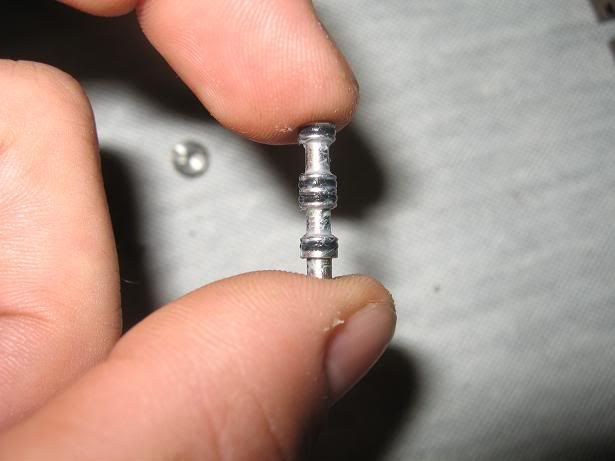

Step #6 Clean it up, replace O-rings that are showing ANY wear, and relube with the 50/50 mix. You will only need a thin layer of lube on these O-ring. Don't over lube them and stay away from any swelling lubes.
Posted ImagePosted Image
To put back together, just reverse steps. You don't need the solenoid piston screw anywhere near as tight as they have from the factory. Just tighten it up, but don't crank down on it.
Also remember those 2 little O-rings that you placed in the bag. LIGHTLY lube them with Dow55 or other swelling lube and don't over tighten the screws that secure the solenoid to the body. Once you feel resistance, tighten each one just a little bit at a time, alternating from one to the other until tight.

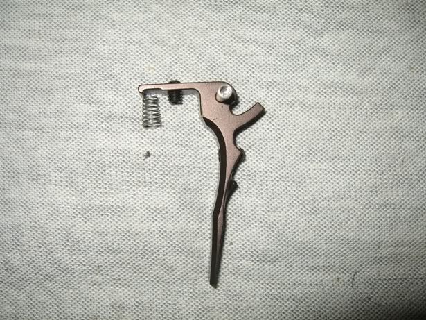

This section is for anyone changing out there trigger or installing a Magnetic Rendition Trigger Kit.
All that is needed is the 3/32 allen screw.

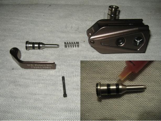

Step #1 Remove the Trigger mounting screw with the 3/32 allen wrench.
Step #2 Remove the trigger out of the top of the trigger frame.
Step #3 Take note on where the trigger return spring is located. If you are installing a Magnetic return, this is where you will be super gluing one of the magnets.
Step #4 This picture shows how the trigger sets inside of the trigger frame. At the far end of the trigger directly above where the spring looks like it's going to touch the trigger, this is where the second magnet will mount for your magnetic return. Make sure that the magnets on both the frame and trigger will repel one another before you super glue the second magnet.
To put back together just reverse the steps.

I have a question for the lube mix 50/50 dow 33 and gold cup is honey lube fine instead of mixing my own lube i heard the is about the same. And also where can i buy Voltagepb Blood because u said that is better than dow 55
Edited by Babapb, 01 February 2009 - 08:22 PM.
Avalanche Ego 09
XSV Velocity
Ninja 68/45
Feedback +1/-0
#11 meMYSELFnI
meMYSELFnI
  • 67 posts
Posted 06 February 2009 - 10:59 PM
I wouldn't say Voltagepb lube is necessarily better, it's just has different properties then the typical Dow 55 lube. It's great for staying where you put it.
It can be ordered here http://www.freewebs....in/products.htm
I've done quite a few deals with Donna and she can be trusted. I would also suggest getting some 1oz Syringes. They make applying the lube really easy. The stuff stays slick, so putting it on your fingers.. it has to wear off, even if wiped with a towel.
Slick honey is good to use on the bolt for the most part, but it's a good idea to swap to the dow33 oil mix from time to time so the vented air will lube the noid.
I should mention also that it's a good idea to lube the #3 oring with dow55. No that's not a typo. That oring is a sealing oring and you'll have less problems if you lube that one with a swelling lube. If your getting excess friction (body heating up really hot at high rates of fire) lube it with dow33 to prevent it swelling any further.
