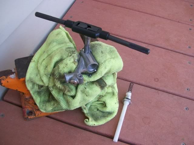

I got one of the hardest things done which is drilling out and threading the talons powertube, It can be tricky to do with
out a drill press mainly becuase you have to drill into a rounded peace of metal perfecally straight :P . It would have been alot
easyer if I was in school right now to do it because I have a drill press in all of my class's like auto and welding. I took my
time and it turned out perfect, the threading is really clean and the macroline fitting screwed in perfect. Oh and I also
went to my paintball shop today named the bunker. got all the fittings and macroline. I might not use my 68/45 on the talon just beacuse
the regualtor on the tank is much longer than a co2 tanks plain valve would be. It just seems really long without a drop on it and im useing
a asa that was ment for co2 tanks just like the palmers regulator, so i might use co2 on it instead. It would work just as good if not better
with the palmers so im still happy. :lol: I havent got any JB weld yet I will try to get some tomorrow to mount the remote lines on/off and I

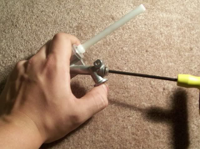

have to fill in the hole were the 12 gram pericing screw was. I drilled it all the way out and will seal it shut. I think thats it, heres the pictures-
Heres a picture of the powertube being threaded (I take pictures on my deck beacause it has good lighting, I dont work there :D )
cleaned all the metal dust and shavings out and put it back together, I red locktighted that random screw. Don't know what
it was for, but I dont want it leaking and I dont need it. The hole were my thumb is is going to be filled with jb weld. thats
were the 12 gram piearceing screw was.

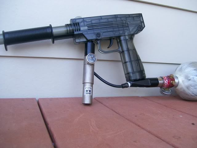

Looking better and more complete but I need to mount the reg!@ :angry:

Awesome work man, maybe you should do something with that empty grip? That hollow space is begging for something

yeah iv been thinking about it, I will find something to put in there im sure :) As for colors IDK what im going to paint it
yet, Im thinking flat black with silver accent peaces. anyways give me your guys opinions on color options. I might just pick it.
I think that random screw might be some type of velocity adjuster for when u r using a 12gram
... Screw it out lets more air get to the valve so there for a higher velocity but I could be wrong

So I got it to shoot, I dont have any pictures as of right now but I got some jbweld and filled that hole were my thumb is in that picture posted above. It hold's air and has 0 leaks witch
gives me awesomeness.Posted Image I hope to have a video of it shooting soon like really soon or at least dryfiring because I dont have any paint at the moment, lol. I really am going

hmmm had a small amount of time today so I made a small video of it dryfiring. Its all I have time for today but hey, its something right? Posted Image
I think it is a manufacturing hole (very common), a hole that exists to allow further machining of the product. In this case I think it exists to allow for a hole to be drilled through the casting from the 12g pierce pin to the valve. The casting is bored out for the pierce pin and the valve but as the casting is a solid piece a tube must be drilled from one to the other, as there is no clear easy path for the drill to take they have to make a hole and then seal it later (usually with a screw). There are a bunch of holes on my Zeus like this and I'm sure that there are other markers like this (especially the cheaper ones that are milled from a solid block of metal).
Personally I think that excessive use of these kinds of holes are a sign of a sloppy design, but sometimes you have no choice and have to use them, the more clever designers find ways to hide these holes.
