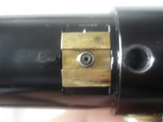

The feed neck is angel threaded, and lock-tighted in. so you’re going to need some force to unscrew it out.
This feed neck is one of the few items on this marker you may want to replace early. I have not replaced it, instead I sanded down my Halo and grip taped it. ghetto luscious, I know. I need a clamping feed neck lol.
The Detent is also Angel threaded. there is only one detent, although I still have not needed to replace it. And I have never had a problem double feeding so I am quite happy with the detent. As you can see on the second picture the detent (white ball) is still round.

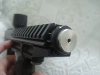

Once you have the marker itself in your hands you’re almost instinctively going to reach for the barrel.
The J&J ceramic barrel is Autococker threaded, defiantly one of the best stock barrels to come with a marker. I have used to time and time again without problems. it’s really light and has a great option to go with the 6 inch front piece for a louder approach to your opponents.
The next part is more of a warning if you plan on buying aftermarket Barrels. Here I have wrapped a small piece of tape around the visible part of the barrel when it is fully screwed into the marker.
The next picture shows the barrel taken out and aligned with the body, To show you how deep the threads are inside the body. This means that barrels with small control bores such as the Hammer Head "fins" can get stuck inside the marker. So if you plan on buying a barrel kit with control backs, which are relativity small. Make sure they are reverse threaded. This means that you turn "Righty tighty" to tighten the back to the marker, and Righty Loosy remove only the barrel. So the back never gets stuck inside the shroud.

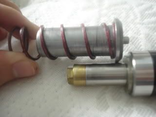

You will also receive a small box with two springs and Spare parts for your Level Ten system. (Anti-chop system)

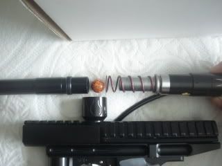

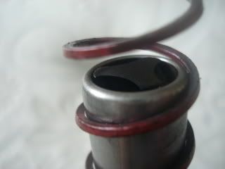

Here is a picture of the smallest spring, the gold spring. Which is recommended for indoor play. (Velocities of 250 and under.)
You have three springs.
Gold - 250 and under.
Red - 260 to 280.
Silver - 280 and upwards.
AGD has been playing around with the springs, only recently have they added a real middle spring, before it was simply a cut Silver spring (so it would act like the middle spring)
point goes to Enhander for reminding me this, should you buy used. make sure to ask the owner what spring is which as they have toyed with the colours and the springs themselves over a few years. so if your like Enhander this may seem more like your set-up:
The Gold spring is actually the middle spring. Silver, Gold, Red.
(I have a few people saying that they are like the ones I posted, rather then Enhanders oddity. So like I said, double check)
You should switch to the spring that is closest to your fields velocity limit. Because if you use the gold spring at 280 FPS sometimes the spring will not fully return the bolt to the marker, This means a bad case of the bolt stick. which means you cannot fire anymore. likewise, if you use the spring that is to stiff, you may not have enough force to shoot it. So if I need to shoot at 250FPS and I put the silver spring in, when I lower the Velocity to shoot at 250FPS the marker wont fire, Because you need to be shooting at least 270 for the marker to operate with the silver spring.
Post two continuation
To adjust your Velocity you insert an Allen key into the slot, then turn clockwise to increase velocity, and counter clockwise to decrease velocity. When adjusting the velocity be cautious, a small increment can mean the difference of 15 FPS, when changing to a stronger spring, put the new spring in, air the marker up and increase the velocity until the marker shoots. Then chronograph for the Exact Velocity. When going to a weaker spring, adjust the velocity Downwards until the marker cannot fire, then switch springs and re adjust velocity.

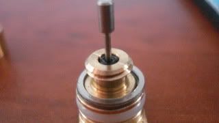

Here is a picture of the main internals, I have placed them respectively above the shell, as if you could see through the main body,
Next is the Level Ten, The level ten system is the Anti-chop system. It works by creating a Balance of pressure going one way versus pressure going the other, As Tom said: Think if it like a teeter totter. You can have 1000 pounds on one side, but when you put 1000 pounds on the other, it doesn’t seem that heavy.” So the bolt pushes forward with the same respective force that the spring pushes backwards. When this balance is off-set by a paintball then the spring has more force then the bolt, meaning the bolt returns to its original position. With out putting pressure on the paintball.
The tip of the bolt has a little soft cushion on the tip. Some people have had these fall of, but the marker still works fine, without problems. Needless to say myself, the level ten is a Genius mechanical way of stopping chops. Should you have a properly tuned level ten and chop a ball. Take a picture because it will be the 8th wonder of the paintball world. People have failed Trying to make the level ten chop paintballs.
Tom was so trusting of this system he put his own tongue in the breach of an X-mag with the eye’s off. Rolled bills have escaped unharmed and the level ten was so revolutionary, so amazing. They completely skipped levels 8 and 9.
The tube itself is called the power tube, the different systems such as the level 7 or level 10 are put inside the power tube.
