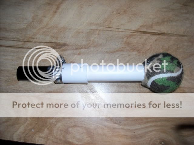

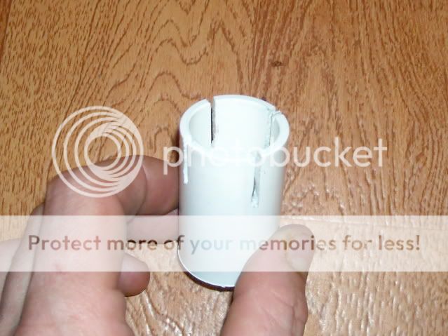

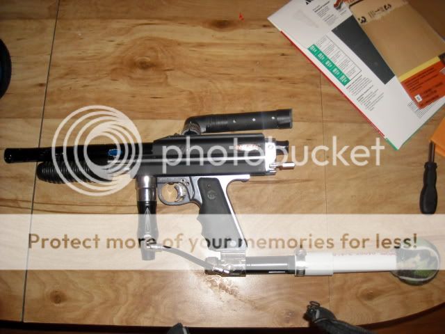

I thought I'd share this with you guys. (I'm sorry I take crappy pictures)
CCI bucket changer, pipe clamp, 3/4" straight pvc coupler, 3/4" pvc pipe, tennis ball.
Cut the coupler like this.
Assemble.
Now I just gotta paint it black to match.

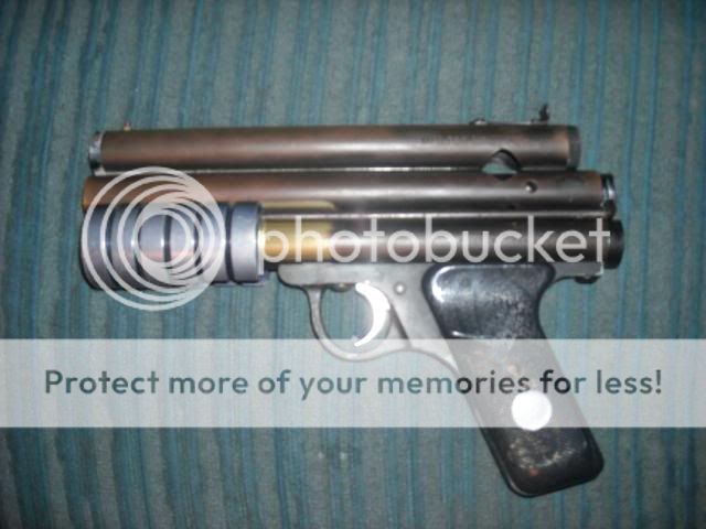

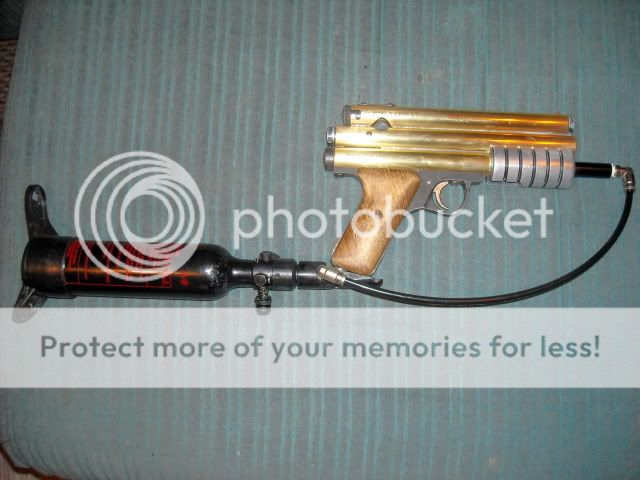

So I finally got my PGPs "makeover" finished. I saw everyone else's on here and elsewhere and decided I had to do something to mine, or it was rarely going to get used.
It wasn't in the best shape when I got it and it only got like 15-20 shots per 12 gram with bad dropoff. It also doesn't have a fast change so changing 12s in play sucks. It was either buy a fast change or put CA on it. I thought CA would make it a lot more playable.
So I got a Palmers CA adapter and their valve rebuild kit and rebuilt the valve. Installed an old ASA and some macroline. Drilled a few ball counter holes and polished the hell out of it (took forever, 500 grit, 1000 grit, coarse steel wool, fine steel wool, and a bunch of brasso.). Put my 13 ci tank on there and I've got me one fun gun. Played with it today and it's shooting great.
I need to find a harder spring, I can get it to 250 with the RVA all the way in, which is the limit at the indoor I play at right now, but I'd like to get it closer to 280 for the woods. I'm also working on getting some synthetic stone (something pretty like marble) to make some new grips and probably a new pump handle, maybe a longer one. You never know, it could end up with a slider frame on it in the future.
And here's an old pic for comparison:
