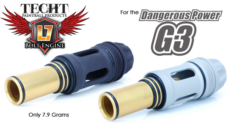

So, ever since I bought my Dangerous Power G3 here on BST its had issues with FPS dips and spikes. Sometimes It will behave but for the most part I end up having to set my FPS at like 240-250 to account for the +-30FPS random shots. Every now and then I got bolt stick so I slowly over a year or two upgraded it. ( I play in bunches, get into paintball and fall out )
1st: techT bolt engine which helped with bolt stick and a bit of the +-FPS
