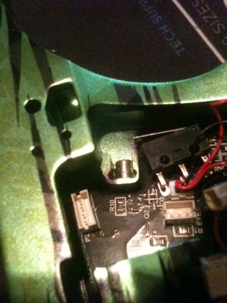

2. Next disconnect the eyes and noid from the board then remove the rear screw(all year dm/nts) and depending on the year dm loosen the front screw and slide the frame off(older dms require you to remove the front screw all the way)

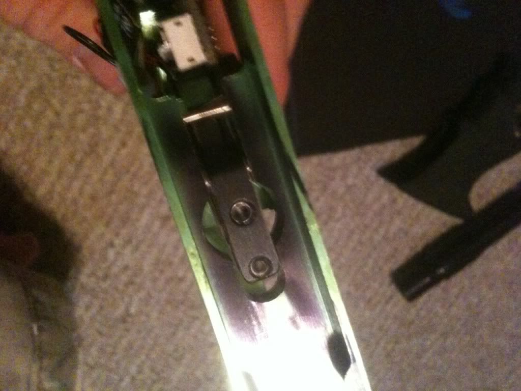

3.Now that the frame is free remove the trigger pin and adjustment screws the stock trigger can be removed now
4. now you should install the frame magnet that came with the critical trigger (make sure that the magnet repels the one on the adjustment Screw before you glue it in place)
5. now install the critical trigger and the trigger pin just reverse of step 3
5a.If the trigger drags at all on the frame you may be required to file the frame or trigger down(i have a tiger lime dm12 and with the mutli layer anno it made the space for the trigger alot tighter then a normal color scheme would be
6. re install the trigger adjustment screws (now is the time to adjust the activation point on the trigger it is located on the top of the trigger and cannot be reach when the marker is reassembled)

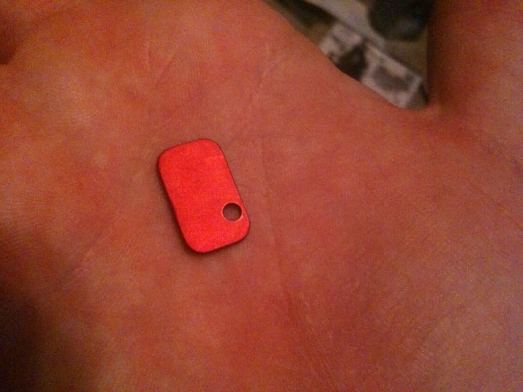

For nt owners only
There is a little red plate that came with the trigger it is to be installed where the first orange wire holder is on the underside of the body using the stock screw
